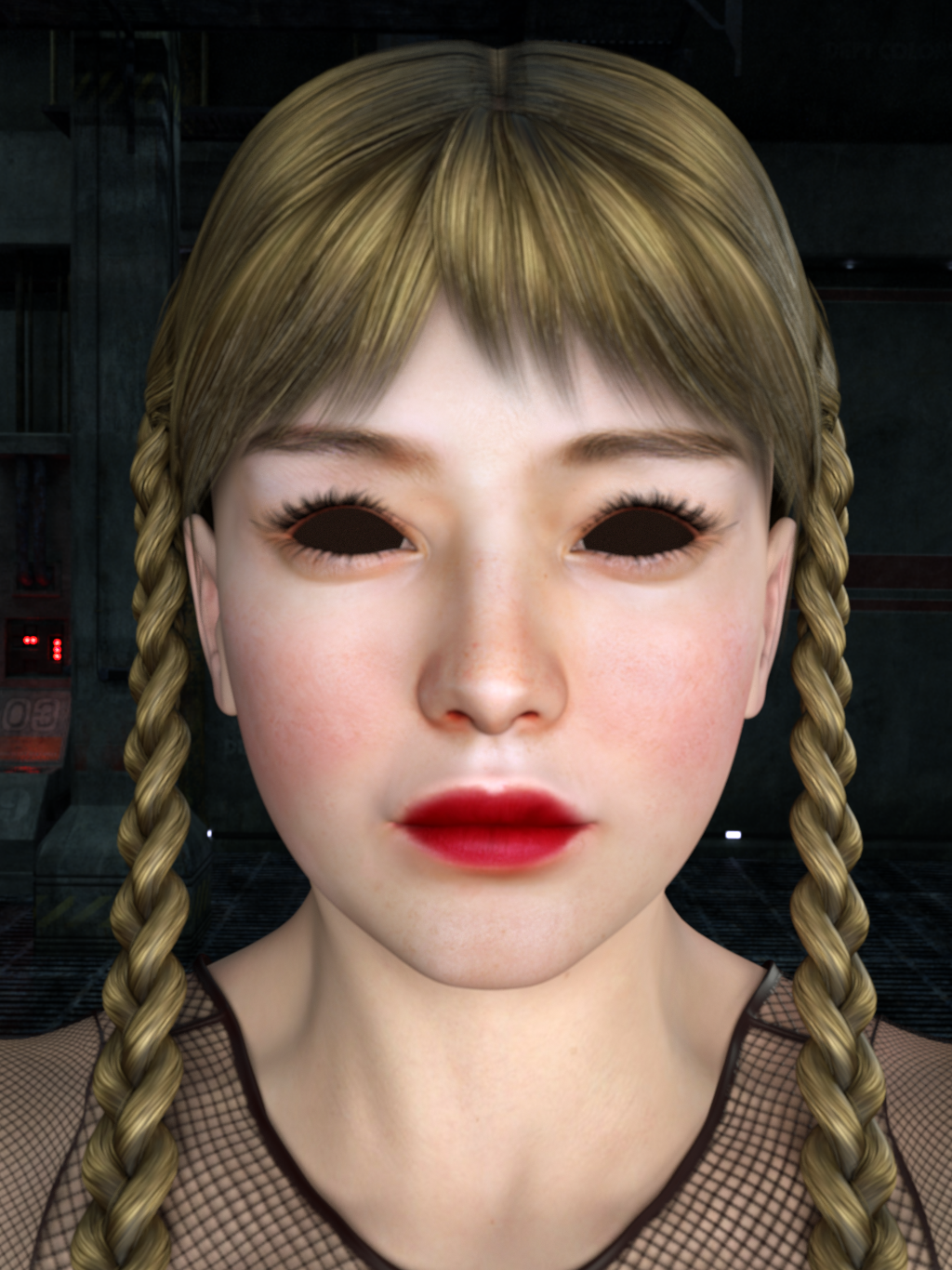

Octane cannot render eye, show my sample, Poser FireFly and SuperFly has no trouble, but Octane Render can't render eye.
At rendering time, I try to check by Material Picker on Octane rendering screen, Octane Material tab locate at SASHA-16 -> 2_SkinHead, not 5_ any eye materials.
I feel that this trouble is "dose not render eyes".

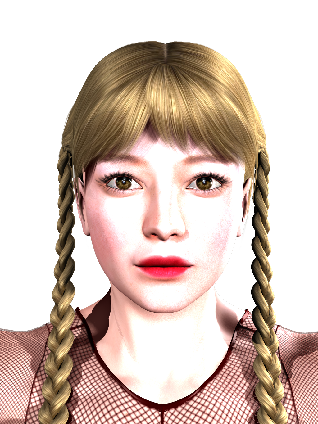

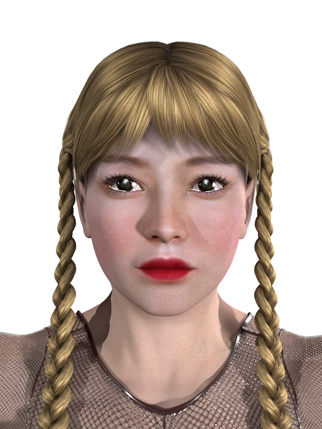

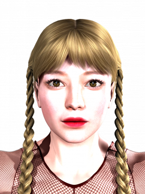

Octane
Octane
FireFly
FireFly
SuperFly
SuperFly

Thanks for providing a test scene. Her eyes are black because the eye geometry is not being provided by Poser. I need to investigate some more as to why this is the case. I will report back here once I know more.

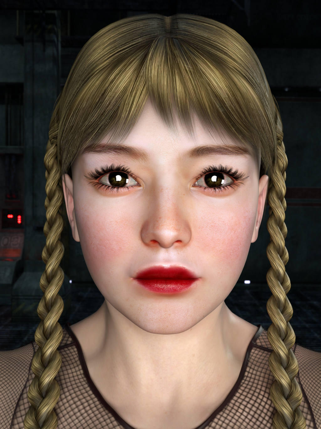

I found that this problem is cause by Figure->Skinning Method->Poser Unimesh as 1 or higher.
I set this value as 0, it can render, show attached picture.
