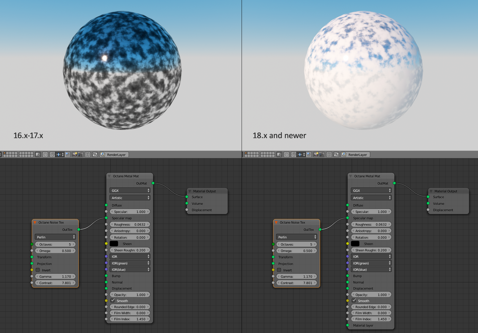

1. The diffuse color in Metal material in 17.x is black. In 18.x and 20.x it is white. This introduces compatibility issues with scenes created in 17.x and before.
2. There should be a color picker already by diffuse input like it is in Diffuse and Glossy material. Now it's just an empty input.
[17.x-20.x] Metal material issues

The diffuse color is made as empty input to keep consistent with SA.
About the black/white diffuse color issue, I cannot reproduce it as it's an empty input from the beginning so it should not be assigned a color automatically. Could you please show me how to reproduce it? Thanks.
Same material different look. I checked in Standalone and it is the same. I guess it needs to be fixed there first.
