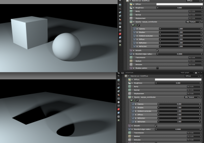

Now my scene have a beautiful shadow using some model blocking the light.
So I should hide the model if I want to render it. But how can I hide it and still hold the shadow?

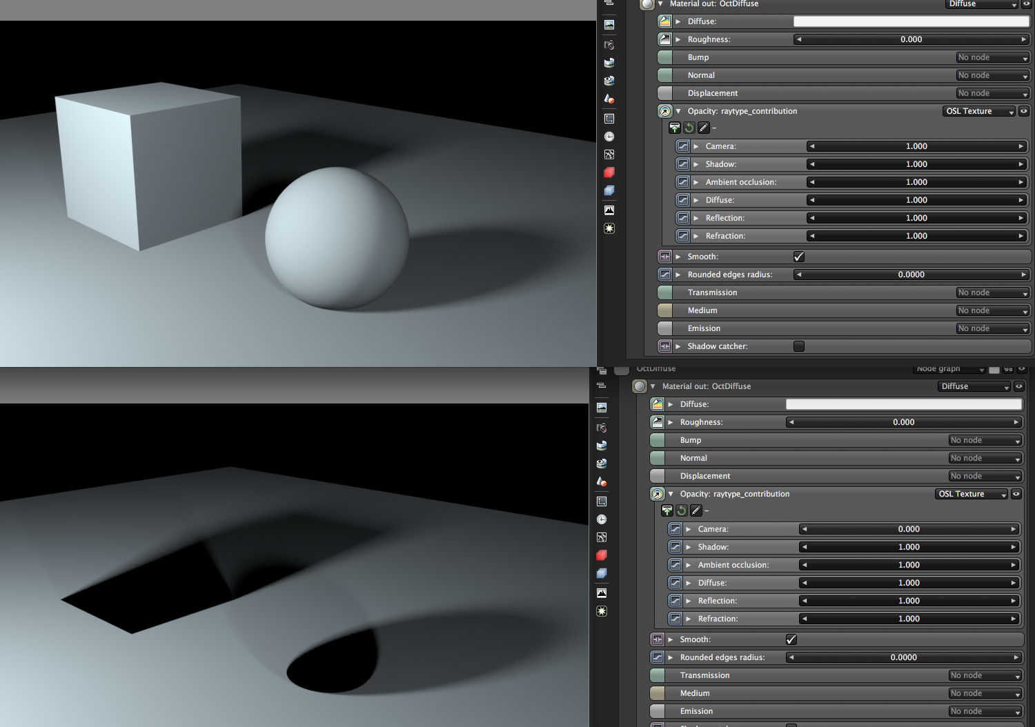

Try the Object Layer node.
https://docs.otoy.com/StandaloneH_STA/S ... visibility
Or, for more subtle control over multiple light rays, Give Calus's RaytypeContribution OSL shader a try.
viewtopic.php?f=21&t=71597
Raytype_Contribution Shadow Caster
