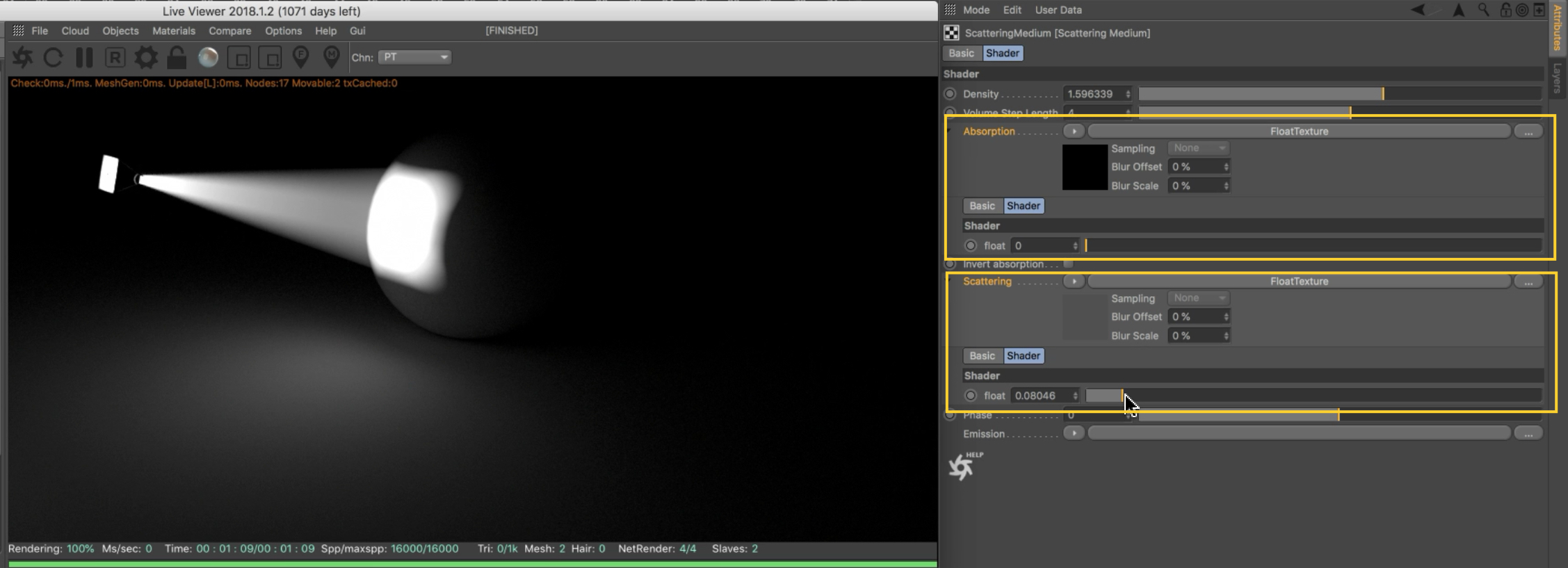

Posts: 10598
from 2018, there is a new Octane Spot Light object:
If you are still in v4, have a look at this other example:
viewtopic.php?f=98&t=63343&p=323590&hil ... ks#p323767
