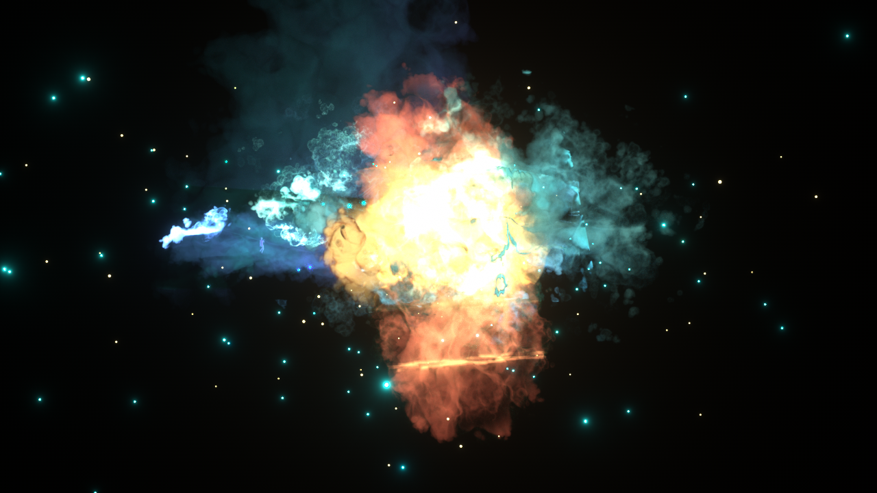

Thank you so much for the reply and tutorial link. i will definitely check it out!. I got some nebula-adjacent looks with emission (still not sure about the ramp though) but the light from the emission is showing the outline of the volume container, im not sure how to manage that
Posts: 10613
check to have the same Volume Step length value in the Volume Medium node, for both the overlapping .vdb files.
