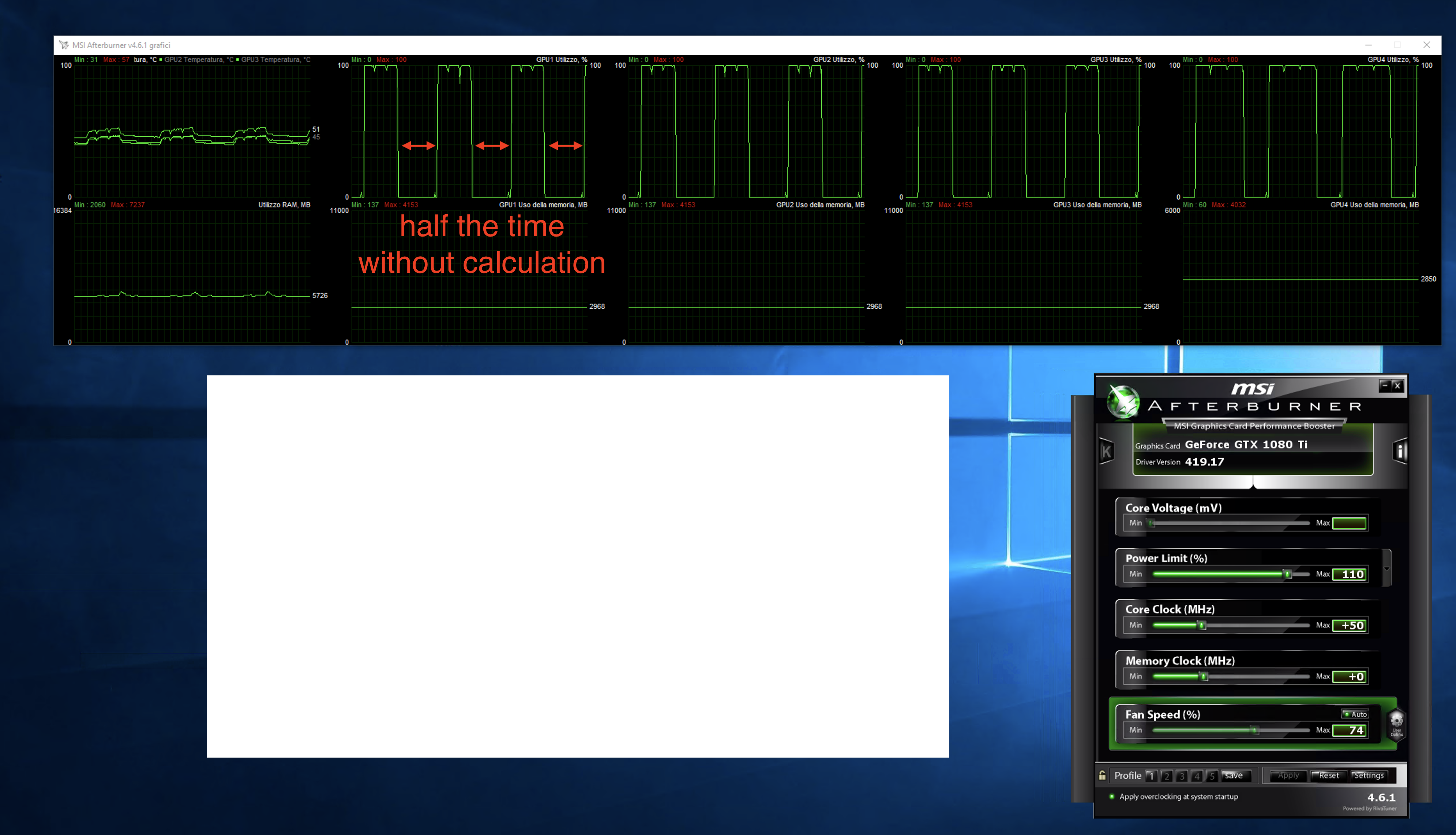

I'm making a video that shows all the phases of a construction site, and I have to try to optimize the performances in the best way. ;)
I noticed that pass a lot of preparation time for each frame, there is some way to optimize?
Every scene are quite simple with few polygons and materials.

Please post render log output from "console" window.

I see your preparation times are about just 1second per frame. Did you send correct log file?

Yes,the log file is correct. The slave was working as you can see in this picture
Now I have finished the video but it would be interesting to understand what caused the problem. Maybe by the LAN?
