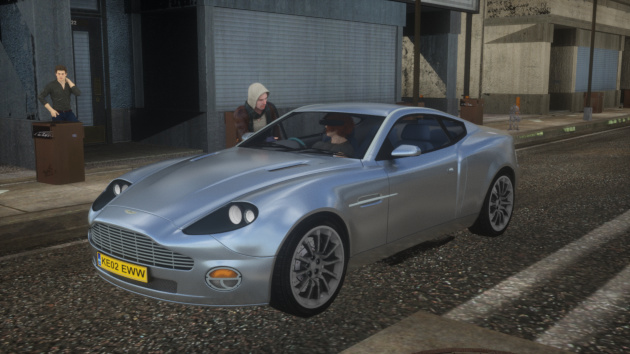

Hey .. so I had some problems with this scene. On one computer I rendered this fairly nice image 'Connors Car with shadows' .. and then I started having problems with octane as the car dissapeared from the render every time I tried to get another shot.
After switching over to my second computer that wouldn't even load a scene .. turns out that was down to my recently updating to the latest NVIDIA driver. I rolled back to 417 and now that works .. and the scene once again will render.

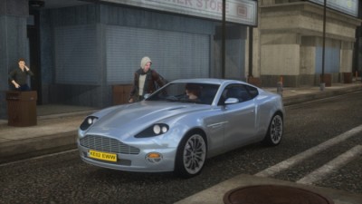

However .. I can't get the shadows to behave for the life of me. I've tried to use the very same setup .. I don't understand how this scene has completely different lighting. Does anyone know what has happened to my shadows .. and why everything looks terrible now?
Shadows not being generated anymore?

Okay .. it seems that after some playing around with this it may have well been texture memory. Even though octane reports tonnes of space left on the cards VRAM .. it seems to not be happy on my second machine. Upon remounting this session on my primary device (after sorting out the NVIDIA driver) .. I have my shadows back once again.
I wish the memory allocation on octane would be more accurate .. when it shows as 2-3 gigs of VRAM empty .. then why the hell is there not enough f**king RAM?
