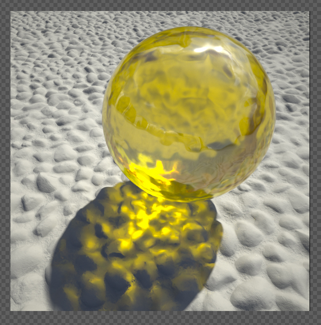

your scene is completely out of scale with no unit of measurement, you are using unreal hidden lights and using the physical sun at 500 power, you are also using the wrong materials (if you want to get caustics mixing specular and diffuse material is not the right way).
This screenshot is a PT 7 min GTX1070 render.
viewtopic.php?f=80&t=56569&hilit=causti ... 10#p290648
