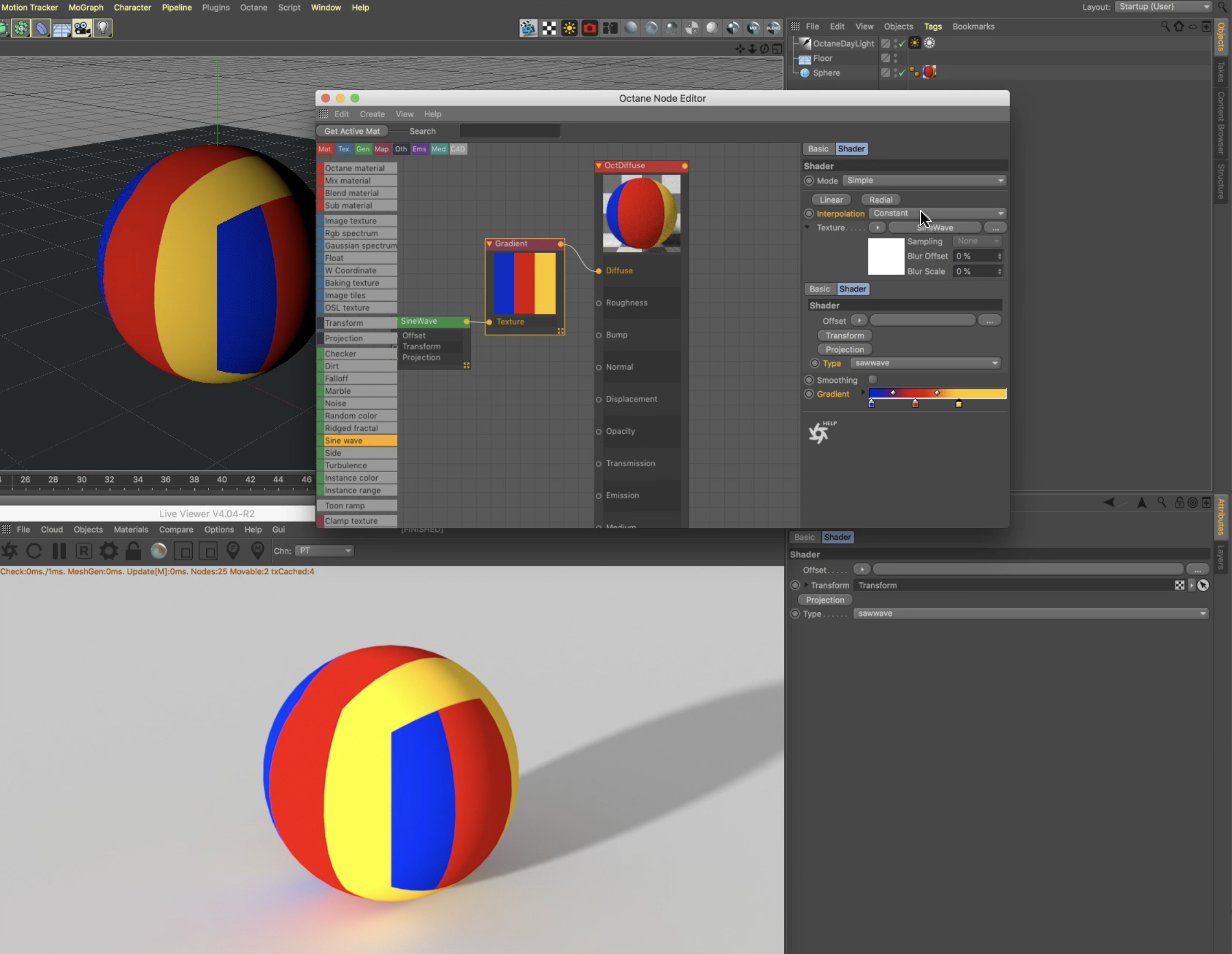

you can use a saw wave node, connected with a Gradient node, and Constant interpolation:

Thats a really great solution Bepeg4d!
Thanks for the post and for the image example.
