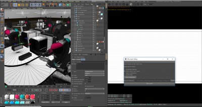

I'm having a hard time exporting a .orbx file to upload to ORC. Every time after I choose my save destination, the window gets stuck on "Preparing for export." When I check task manager it says C4D is "Not responding"

Have u tried to export a simpler version of this scene or any other? Also tried to export a different location in to hard drive with not having writing protection?

@zram94 - Are you sure it's crashing? Sometimes my scenes take quite a while to export ORBX and they seem like they are hanging when they are calculating. Also, I have had problems with Mask ID's and DeNoiser in the past when exporting for ORBX, so I will disable those things and try. I have noticed that if you have DeNoiser enabled in your camera imager, it will automatically render a Denoised pass in ORC now, which it never did before.
I had a few problems in the past with Mix Materials, but a lot of that went away when I started using v2018 (not sure what the cause was).
I also have had the export to ORBX function hang and crash C4D...open it up, try again, and it immediately starts working. So it's definitely a little buggy still, but I've been able to use ORC fairly successfully over the last year without too many issues.
