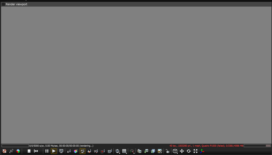

I'm using a Quadro P1000, and as shown in the image, it says the gpu is failed. Any one can help me on that? Thx!!!

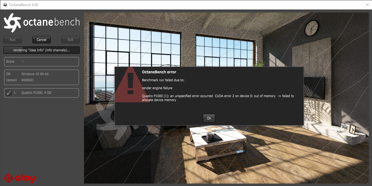

bepeg4d wrote:Which version of Standalone are you using?
Are you able to run OctaneBench 4.00c?
https://render.otoy.com/downloads/a/787 ... 0c_win.zip
ciao Beppe
Thank you for your reply!
I'm using 4.01, and it seems I can't run OctaneBench, either. It says failed to allocate device memory. Not sure how to fix this. Thx!

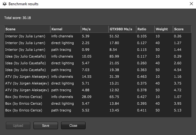

the Octane Bench works. But the octane standalone stiil says Quadro P1000 failed. I opened out-of-core, not sure if that matters
Posts: 10619
4.01 is too old, and cannot work with latest Nvidia drivers.
Please, upgrade to 4.05 and report back:
viewtopic.php?f=24&t=71916
ciao Beppe
fcstudio
Posts: 4
Joined: Fri Feb 01, 2019 6:07 pm
bepeg4d wrote:Hi,
ciao Beppe
That works! Thank you so much!
