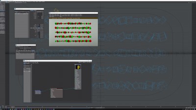

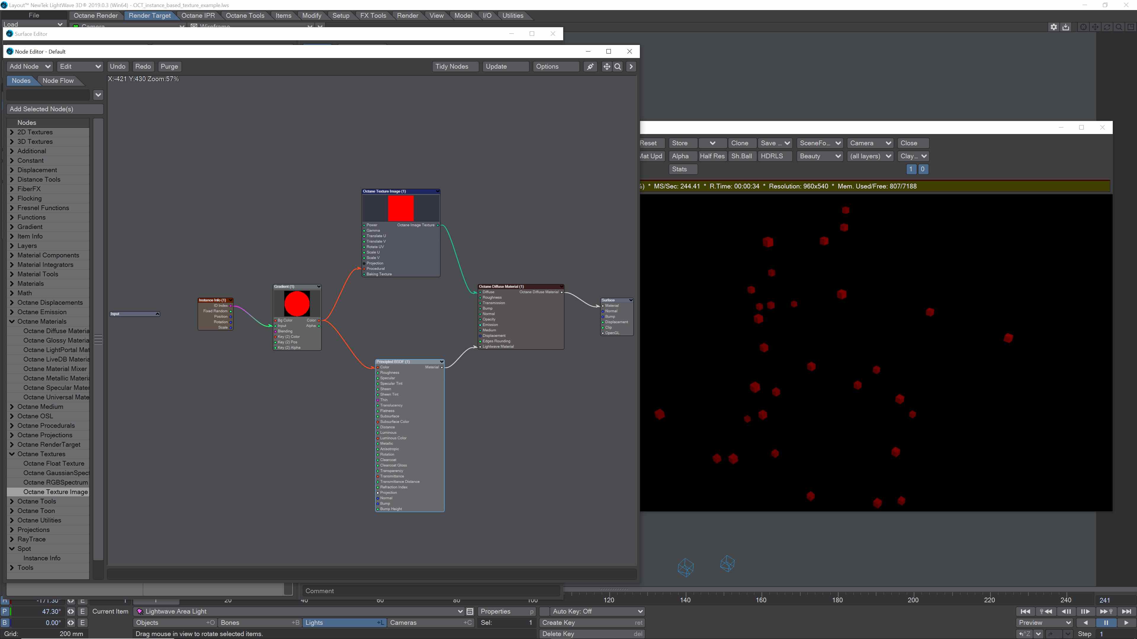

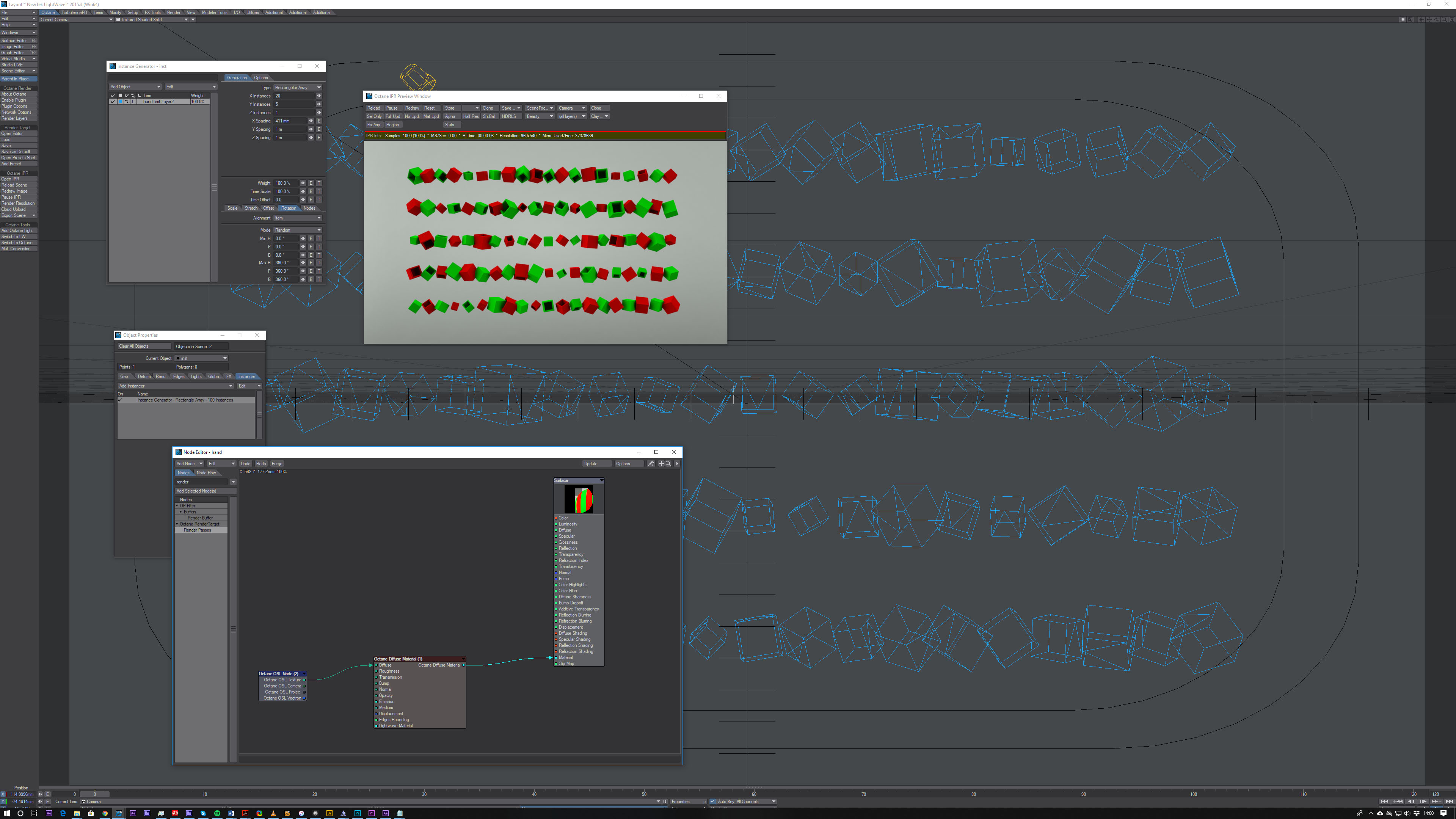

Congratulations, I think you've discovered a bug in OctaneRender's Texture Image Node, because this should work.
Index ID of an instance as the input to a LightWave Gradient node, which in turn feeds the Diffuse channel of a Principled BSDF node
OctaneRender Image Texture Node ignores the procedural output of a Gradient node
I've also attached the LW object and scene demonstrating this (or rather, demonstrating how this does not work).
instanced_color_demo.zip
Zip file containing demonstration LightWave object and scene, showing how instanced color works in LightWave but not OctaneRender
(10.18 KiB) Downloaded 600 times
Octane 2020.2.3.1 | LightWave 2019.1.5 (3134) | Win10 Pro 19041.1052 | 2 x Gigabyte AORUS RTX 2080 Ti Xtreme w/NVLink | Gigabyte AORUS Xtreme X399 | AMD Ryzen 2950X | 64 GB RAM | SSDs: Samsung 970 PRO 512 GB + Seagate FireCuda 510 2 TB | blog.gammans.zone

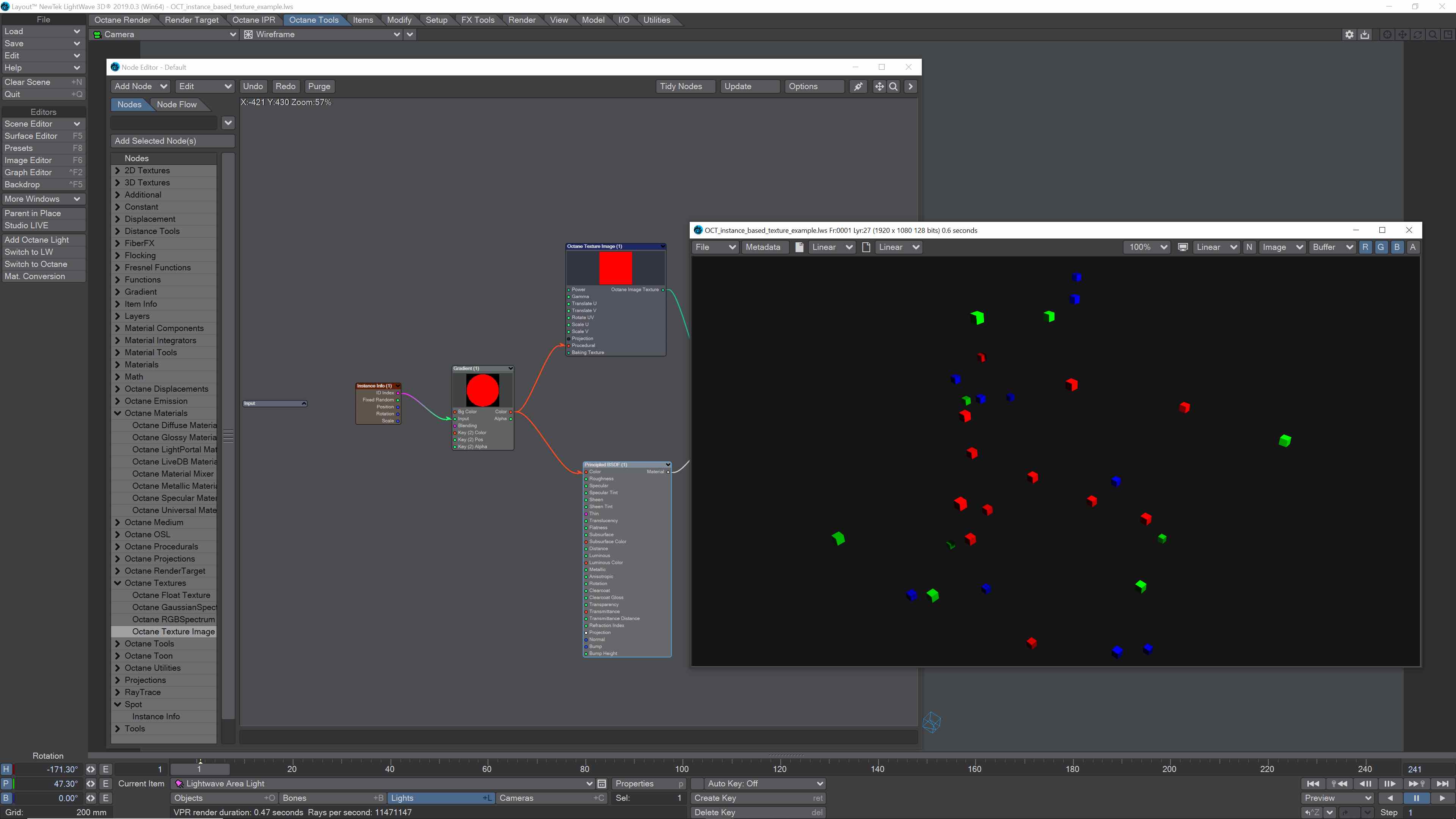

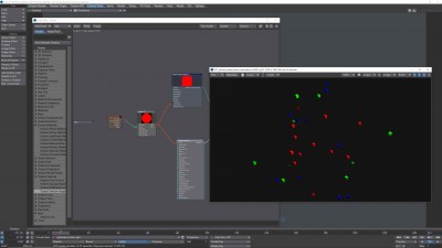

I've made a bit of progress with this using OSL.
The hit:instance-id attribute always seems to return 0, so isn't much use. The hit:obj-seed attribute is more promising and seems to contain something different for each instance. I'm not sure what the values actually are (they seem to be something close to 100000) but they are sequential. For example this script outputs red or green depending on whether the obj-seed is odd or even. Notice how the resulting pattern is very regular:
shader instanceID(
output color c = 0
int instID;
//getattribute("hit:instance-id", 0, instID); //always seems to return 0
getattribute("hit:obj-seed", 0, instID);
if((instID%2)==0)
c = color(1,0,0);
else
c = color(0,1,0);
