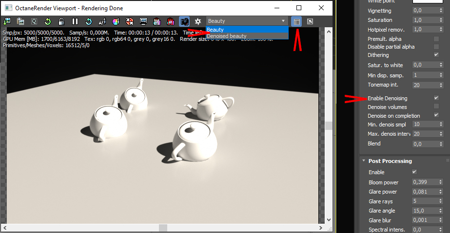

Hi lunarstudio,
check "denoise on completion" in Camera panel.
Regards
Paride

paride4331
Posts: 3962
Hi lunarstudio,
Denoise on completion means that if it is enabled, beauty passes will be denoised only once at the end of a render in this case at the end of the frame, not at the end of the animation.
Denoise will start when max samples achieved its goal (in this case 600), then a new render frame will start.
Before to render the animation, my suggest is have some test do check how much you can reduce max sample using denoiser to have a qualitatively acceptable image.
With very few max samples, it might make sense to reduce min. adaptive sample or disable it.
Regards
Paride

paride4331
Posts: 3962
Hi lunarstudio,
Is there any difference between the per camera rollout settings versus the camera tab in the render rollout?
Camera tab in Octane render setting works using 3dsMax Camera instead of Octane camera.
Also, how long does the denoising take upon completion?...
It depends on GPU performance is denoising and the render size to denoise.
Enabling multiple passes you can easily compare Beauty and Denoised beauty.
Regards
Paride
