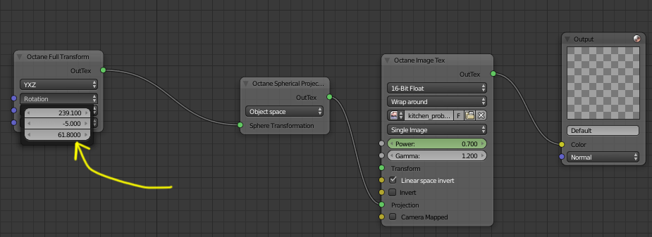

Hi BlendOctaners,
Here is my set up, but I cannot figure out how to animate/keyframe the rotation of the HDRI.
Hovering over the indicated rotation parameters and hitting "i" on the keyboard does nothing.
Any tips? Should be possible. I am able to do this in my Carrara Octane plugin.

linograndiotoy
Posts: 1538
This is a my HDRI setup. You can use the Rotation of the Octane 3D Transform node to control the environment.
I hope this helps.

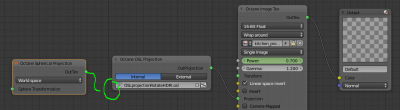

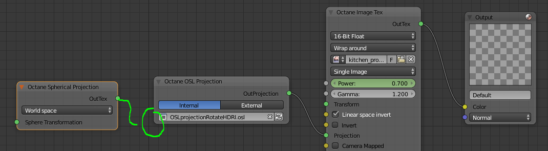

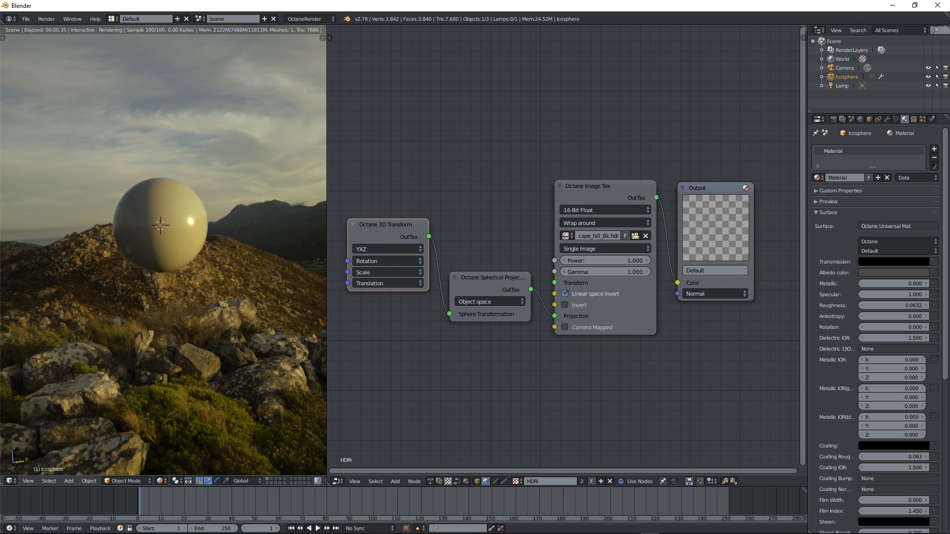

protovu
Posts: 476
Joined: Thu Sep 11, 2014 7:30 pm
Hi Lino,
Thank you for answering.
Seems odd that this limitation exists in one plugin but not in another.

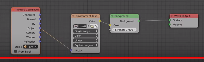

Would it be possible for a Blender developer to check this tutorial: https://www.youtube.com/watch?v=0c_oqn4i648?
It neatly shows how to attach an hdri rotation to an empty, but I can't figure out the Octane equivalent. Here is the setup:
I am assuming that this can be keyframed, but maybe not.
Or maybe a Blender Developer could reach out to the Carrara developer, Simon, to see if there is some information that can be leveraged?
I am dealing with a very complicated scene, heavily rigged and parented. Not crazy about rotating the scene to achieve this.

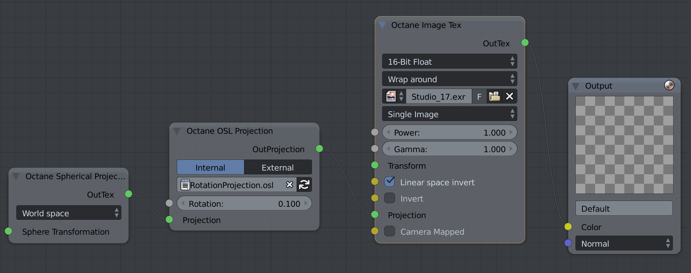

protovu
Posts: 476
Hi Chris,
Thank you for figuring this out.
I copied your script to a text file, and then changed the file extension to .osl.
Correct way?
As you can see in the image above, I am missing the yellow folder icon. How do we enter the .osl file?
Thank you ,
Rick

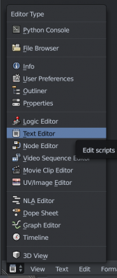

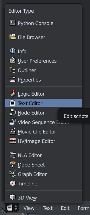

ChrisH
Posts: 103
Joined: Sun Mar 06, 2011 12:13 am
Location: Lidköping, Sweden
Hi Rick!
If you want to open it from a file you need to select "External", and then you'll be able to open it.
You could also open a text editor in Blender, paste in there (or open the file with Alt+O), then you have to use "Internal" (and click the arrows to compile the script).

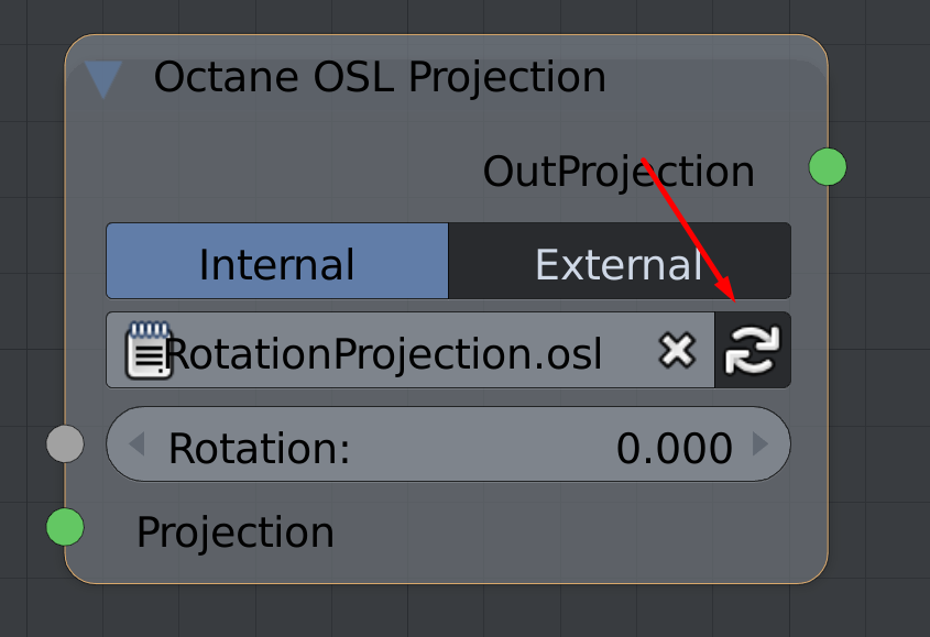

protovu
Posts: 476
Hi Chris,
Sorry to bug with something that must be obvious.......
Where is my input hiding?
ChrisH
Posts: 103
Try pressing the "update/compling button".
It should work directly (unless you're getting an error) .
Windows 10 Pro - AMD Ryzen 7 2100X 8 core 3.70GHz - 32GB RAM - GeForce GTX 1080 8GB
Octane Prime - Blender Plugin user
Metal IOR values for Octane (with .blend library): https://chris.hindefjord.se/resources/rgb-ior-metals/
