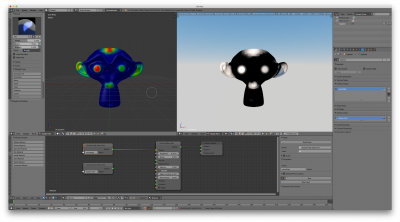

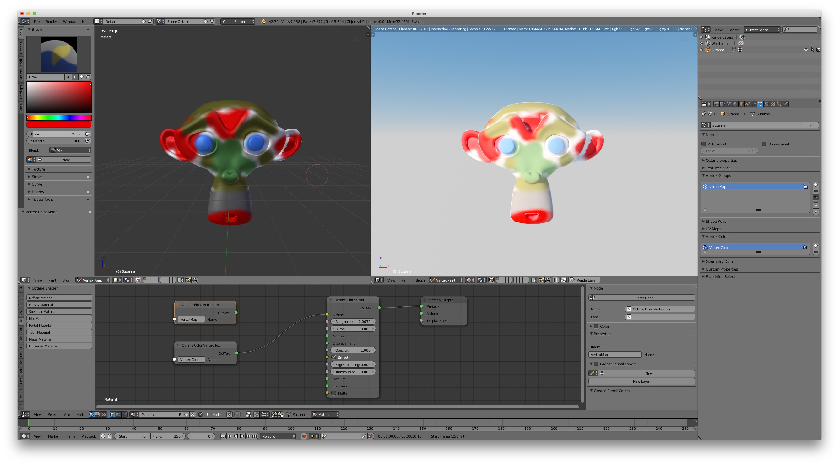

Blender Vertex Groups map (Octane Float Vertex Tex) is useful for creating texture or material masks while Blender Vertex Color map (Octane Color Vertex Tex) can be used for any texturing purpose.
