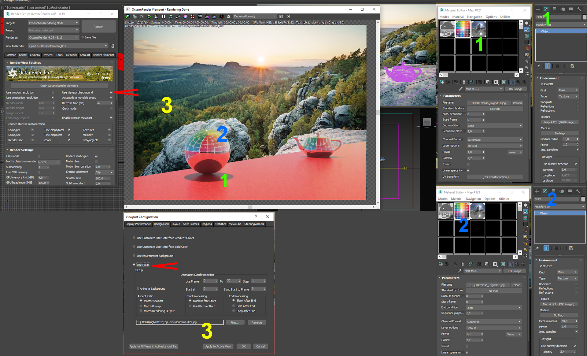

Daylight backplate/reflections/refractions doesn't work. Version 4.05 - 6.19.
I have three daylights. One set to main & texture for lighting. One set to visible & texture with reflections checked. One set to visible & texture with backplate checked. The backplate doesn't work unless I turn off the light that has reflections checked. What is the point of this if you can't have unique maps for each entry?

Hi senorpablo,
backplate would be in 3dsMax Environment background.
Regards
Paride

Why doesn't the backplate option within the daylight system work properly and as one would expect? Does the viewport background backplate method you suggest get exported properly for rendering in ORC?

Hi senorpablo,
as a ux specialist should knows, render target node provides only two pins: Env and vis Env, what you ask for is readily obtainable using alpha channel.
What I suggest is a quick trick allowed using 3ds Max Viewport in Octane.
Regards
Paride
