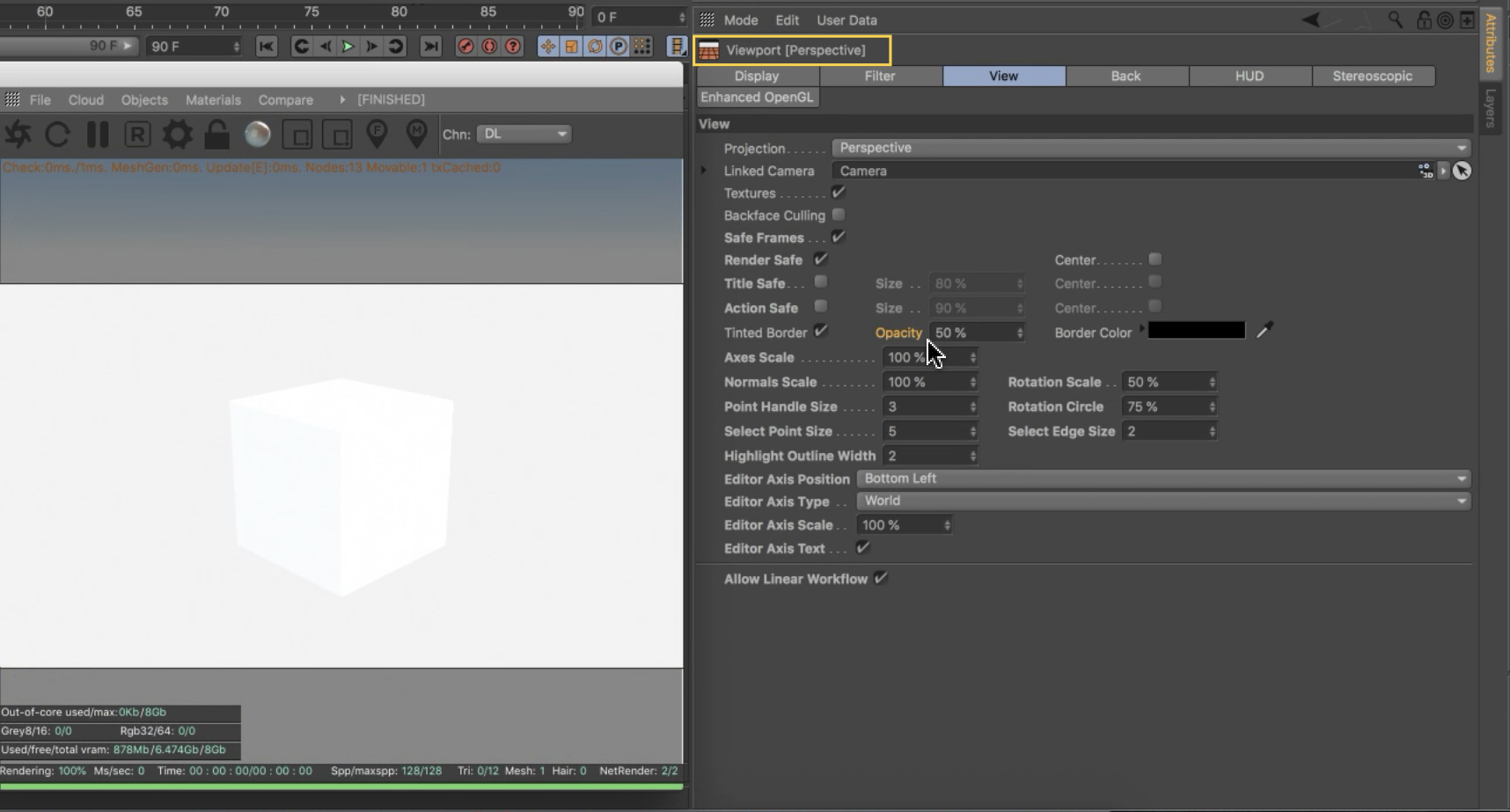

Posts: 10564
Hi nscr,
have you tried to change the Opacity in c4d Viewport settings?
ciao Beppe
