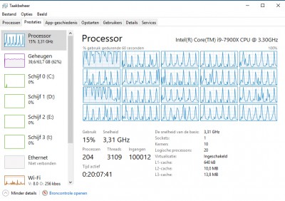

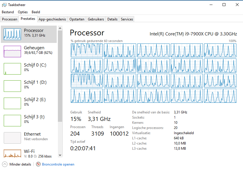

I sometimes get this problem when trying to render out an animation via the Octane plugin the animation doesn't start rendering.
Mostly this happens with a larger scene (polycount of 10 million). When checking Windows Taskmanager the CPU keeps spiking continuously
(see Attachment). It keeps doing this and as a side effect Modo freezes. Any idea what causes this? Restarting the computer and starting up modo
again seems to 'fix' it most of the time. But then eventually the problem arises once more.

CPU spiking
CPU spiking

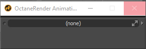

OctaneRender Animation bar stays like this
