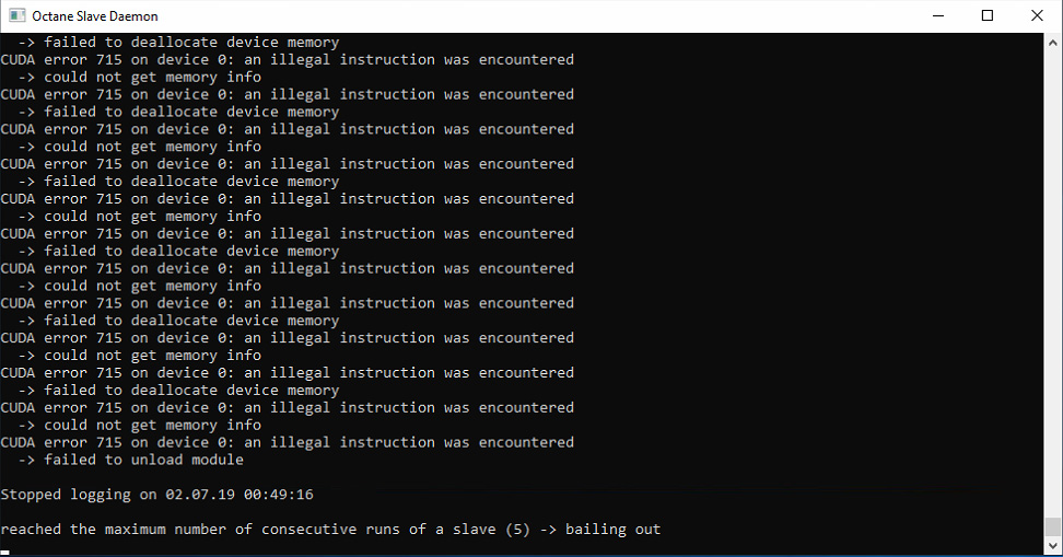

I'm getting this Cuda 715 error on my brand new renderslave (win 10 pro 1809), Asus x299 Sage WS Motherobard, i7 9800x, 201080Ti and 1*1080, Corsair 1500W PSU, 64GB, Octane 4.04, nvidia 417.35 drivers (need to keep them 'coz of octane 3.8.05 can't work with 419.x--->).
It's totally random, sometime it renders for 5 minutes and throws that error sometime reders 2 hours just fine and then throws error so i cna't find reproduction steps but it happens way too often to be just a glitch so maybe it's bug ?
It's very frustrating to leave workstation and 2 renderslaves to render animation and then come back hours later to see that one render slave just gave up render hours ago and it' snot done when it's supposed to be done :(.
If i close commandpromt and run Octane.bat again manually then it puickups and joins render process just fine so my question is can you make it close/reopen *.BAT automatically after those 5 retries instead "bail out" and stop using my slave for who knows how many hours. ?
Or even better FIX that problem in octane core :)?

I have the same issue in a machine with 7x1080. I remember a scene with a lot of instances, i could not render with that machine... and there was memory enough.

Anyone from OTOY ? Is it possible to make that network render service restart itself ? Maybe some command i can put in *.bat file ?
