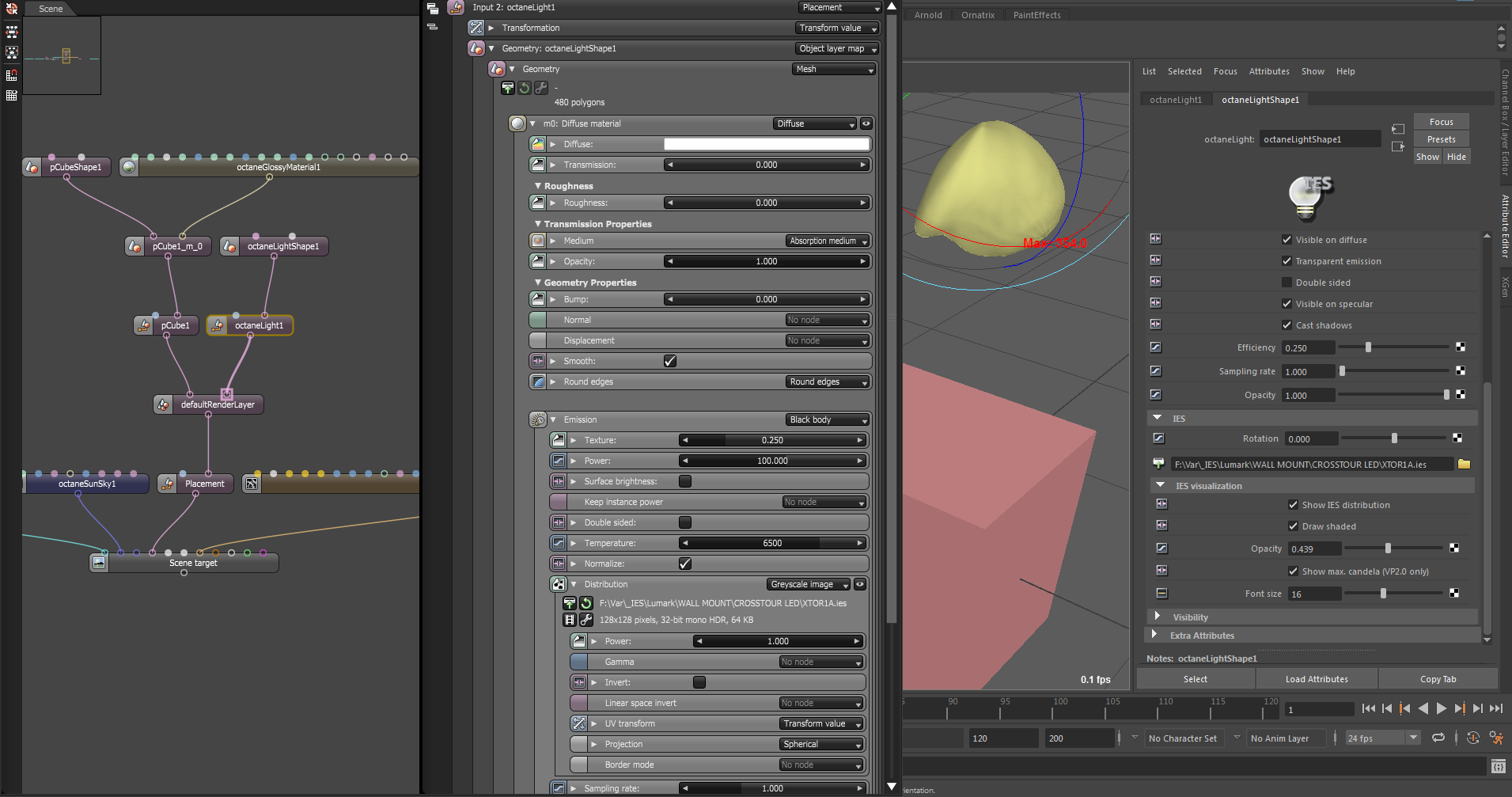

The only sometimes helpful feature of the Maya plugin's fake-light helper - is the ability to visualize the IES light source's distribution directly in Maya's viewport: the Maya plugin implements reach visualization capabilities where you can choose the "wire-frame" visualization or the shaded shape, change the shaded opacity, show the max. candela value, tune its font size: this functionality is not available in the Octane rendering engine itself... I've developed the custom library doing this firstly for 3ds Max, and then improved it and integrated into Maya too...
But other than that - there are no advantages in using a fake-light helper, and you lose a lot of flexibility in tuning of your light sources. This is not only about your ability to tune any parameter (including the one you've mentioned above), but even fine tune the geometry of the light source itself. For example if your light-emitting geometry is big enough and must be visible, you could want to make it much more smooth by increasing the number of polygons, or even make the light-source in a shape of the light-emitting spiral inside of a light-bulb (overkill of course, but it shows an example of how flexible you are when using the light-emitting geometry directly).
And NO, you are not restricted in using IES files when using the light-emitting geometry directly. Here is an example of Octane's native nodegraph utilizing the IES file - that reflects what you get under-the-hood when using the fake-light helper with its simple sphere and an IES file. But in this case (if you have the similar shading-graph of Octane-plugin's nodes assigned to some Maya-native light-emitting geometry) - you can fine-tune any parameters you want in any parts of this light-emitting shading-graph, plus you can have any light-emitting geometry shape you like...
