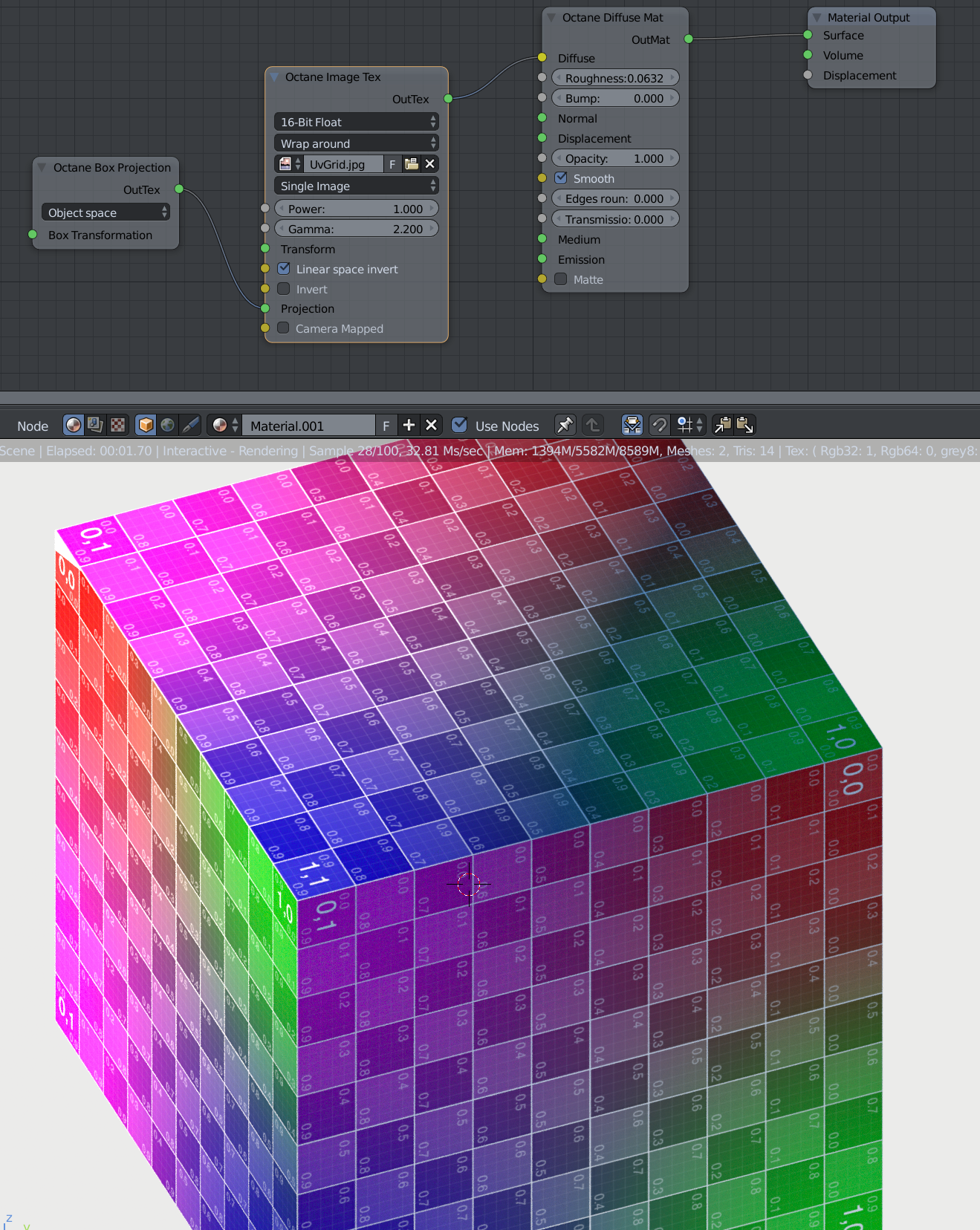

  • You only get automatic UV-maps for primitives if you check the "Generate UVs" in the settings for the Add Operator (F6)
  • For Octane the texture will only show in the Viewport if the object is UV mapped (In Material view it will show the texture connected to Color/Diffuse, in Textured view it will show the texture of the selected texture node [even if it's not connected])
  • If you connect a Projection node to the texture node it should work fine (even without UV mapping) (but this doesn't work in Material/Texture View)

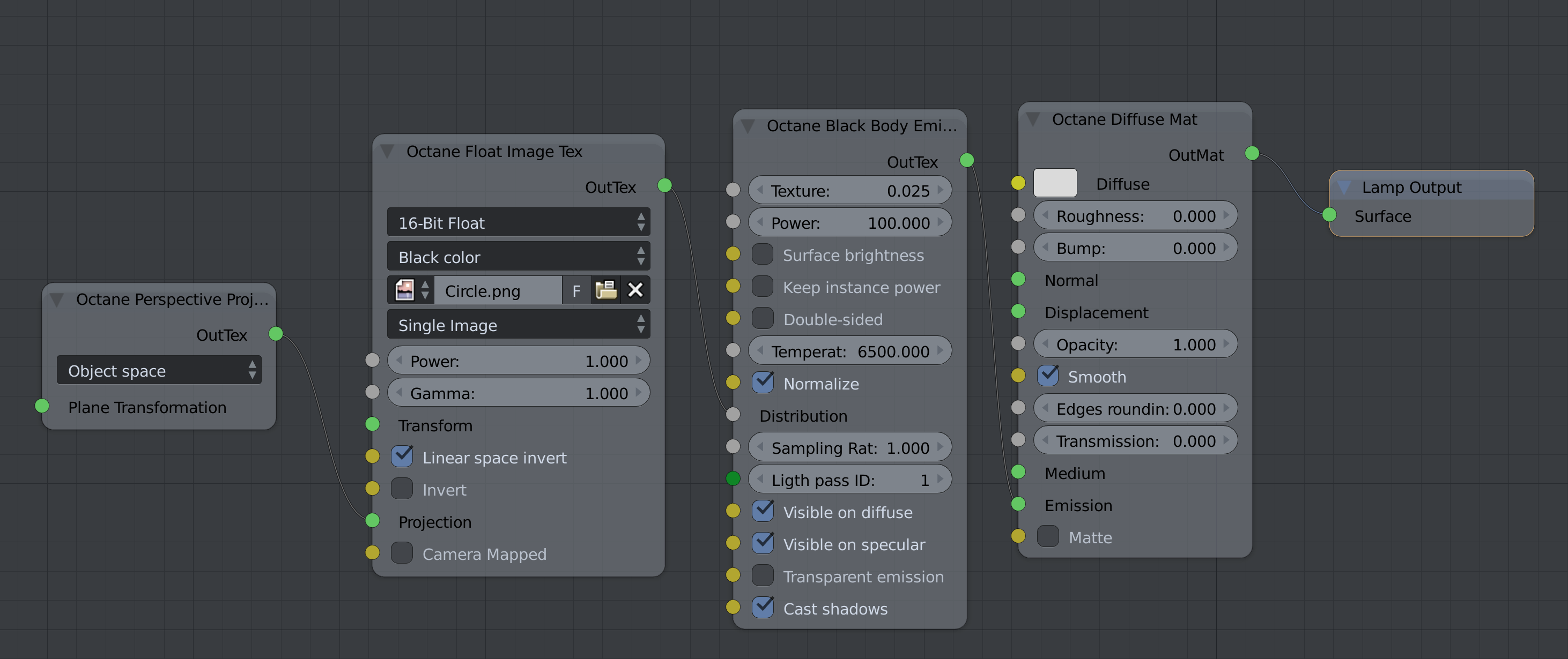

For lighting you "have to" use "mesh lights" (planes etc).
There is (some) support for some of the lamp types:
  • Point - Only as a "toon light"
  • Sun - Used to control the sun in the Daylight environment (didn't get this to work, didn't put much effort in it..)
  • Area - The default material wont work, you have to change it to a Octane Emission setup (A Diffuse Material and an Emission node)
If you want a spot light you can do it like this (In this case with an Area Light Object):
(Texture of a circle, set not wrap [Black color as "Border Mode"], connected to the Distribution of the Emission node, and with Perspective Projection*)
(*You could use "Normal Space" instead of "Object space" for the projection, but then you need to invert the texture in this case. Or you could use a proper IES Profile..)

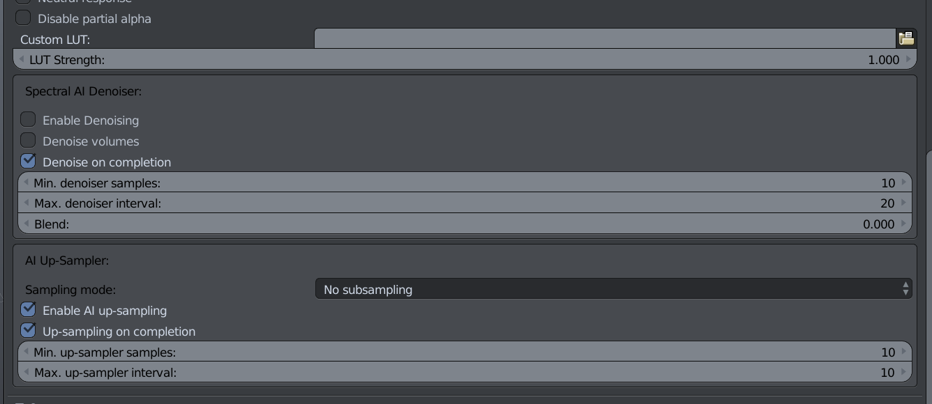

The AI upsampler is only in the test version (2019.1.XB2 - 18.0) currently (sadly only for perpetual license holder, for now..). If you have that version you can find it in the camera settings (below the Denoiser settings)
