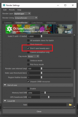

When rendering a sequence using the ai.denozer, Is there a way to prevent spliting the output frames and rendering only the denoized one?
Help will be appreciated.

In render settings you can choose to not save the beauty pass:

Thank you so much for your reply.
I don't have this option in my render globals, I'm using version 4.0.1.1 - 13.22, which version do you use?

Hi Sampakinpa,
Thanks for sharing the version.
Please download the latest stable OFM - 4.05 - 13.46 from the link below.
https://render.otoy.com/account/downloa ... LL&ver=ALL
Cheers
Kind Regards
bk3d
