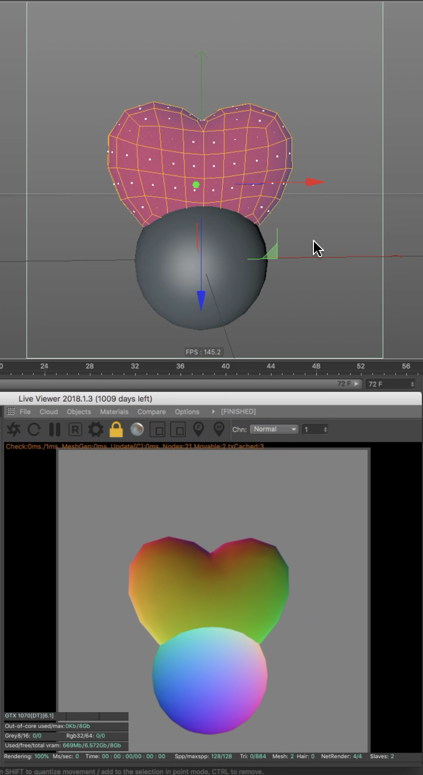

Why isn't the baking camera picking up this heart object? It works with the sphere. The camera just comes up completely black.

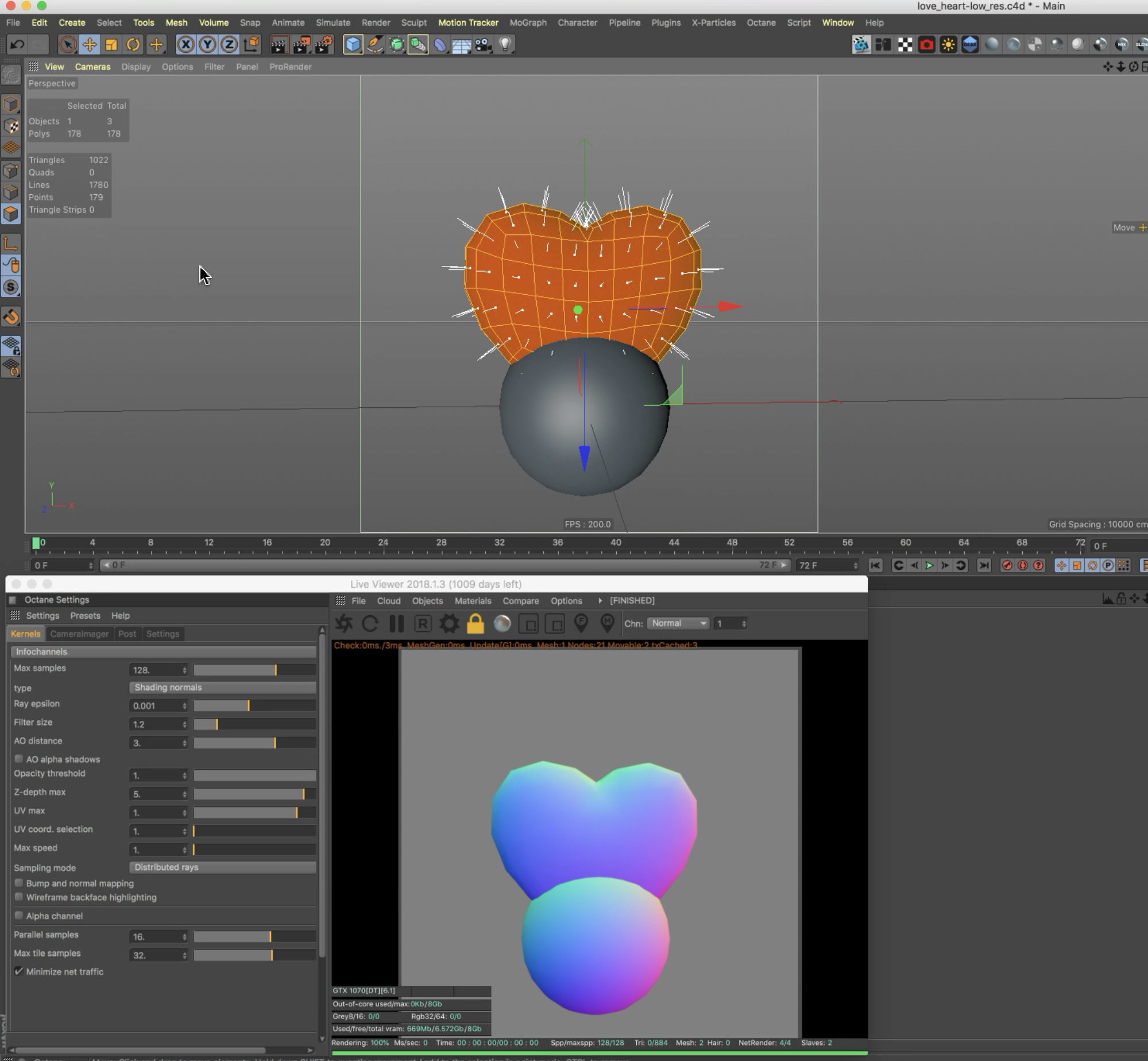

if you switch the Kernel to Info Channel/Geometric Normals, you can see that the heart normals are inverted, so you are currently baking the inside, having a black result:
You need to firstly reverse the normals:

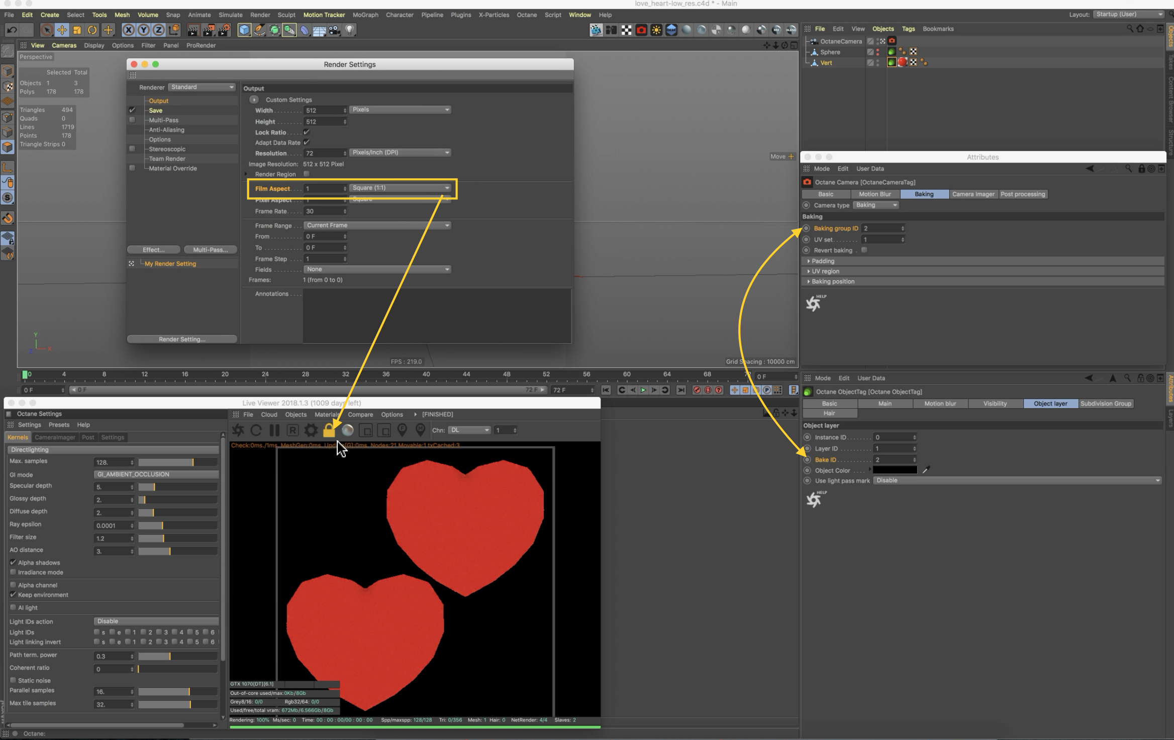

Please, only use Octane materials, hide the sphere, set the Film Aspect at 1:1 to have a square result, assign a different Baking ID to each object tag, and change the Baking ID in the Camera node accordingly:

Strangely that reversing the normals solved that! Didn't expect this behavior.
