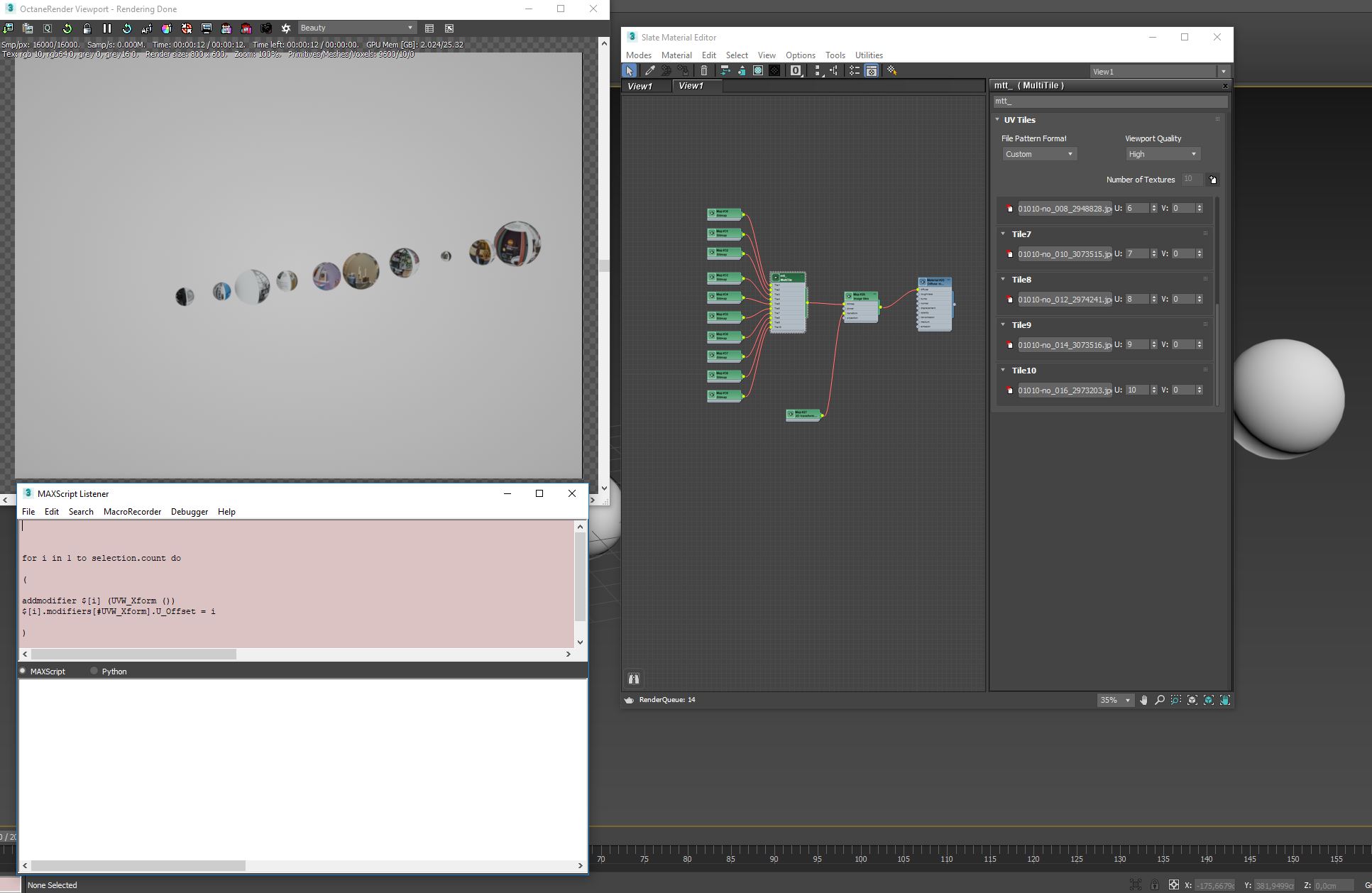

The Tile map might be something that can work.
Is it possible to access it with scripts?
So i can load multiple textures at once?
Right now i need to pick tile 1 find texture, pick tile 2 find texture, pick tile 3 find texture. that will take ages :D

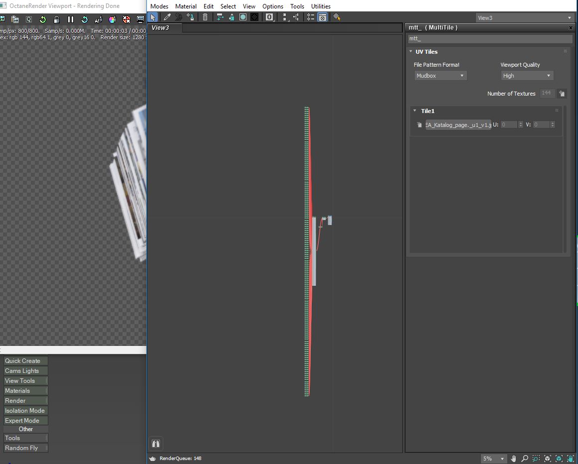

We are moving forward :D
UDIM's seems to be the answer.
Or more correctly, the mudbox version of the UDIM, i dint get the UDIM to work, but mudbox seems to do the trick.
Loaded everything in the folder in one click :)
I belived the UDIM was
But that gave and error "unsupported format"
-Mats

HHbomb
Posts: 1438
you can use : http://www.scriptspot.com/3ds-max/scrip ... map-loader
with subobject mode selected, and then convert to octane materials.
