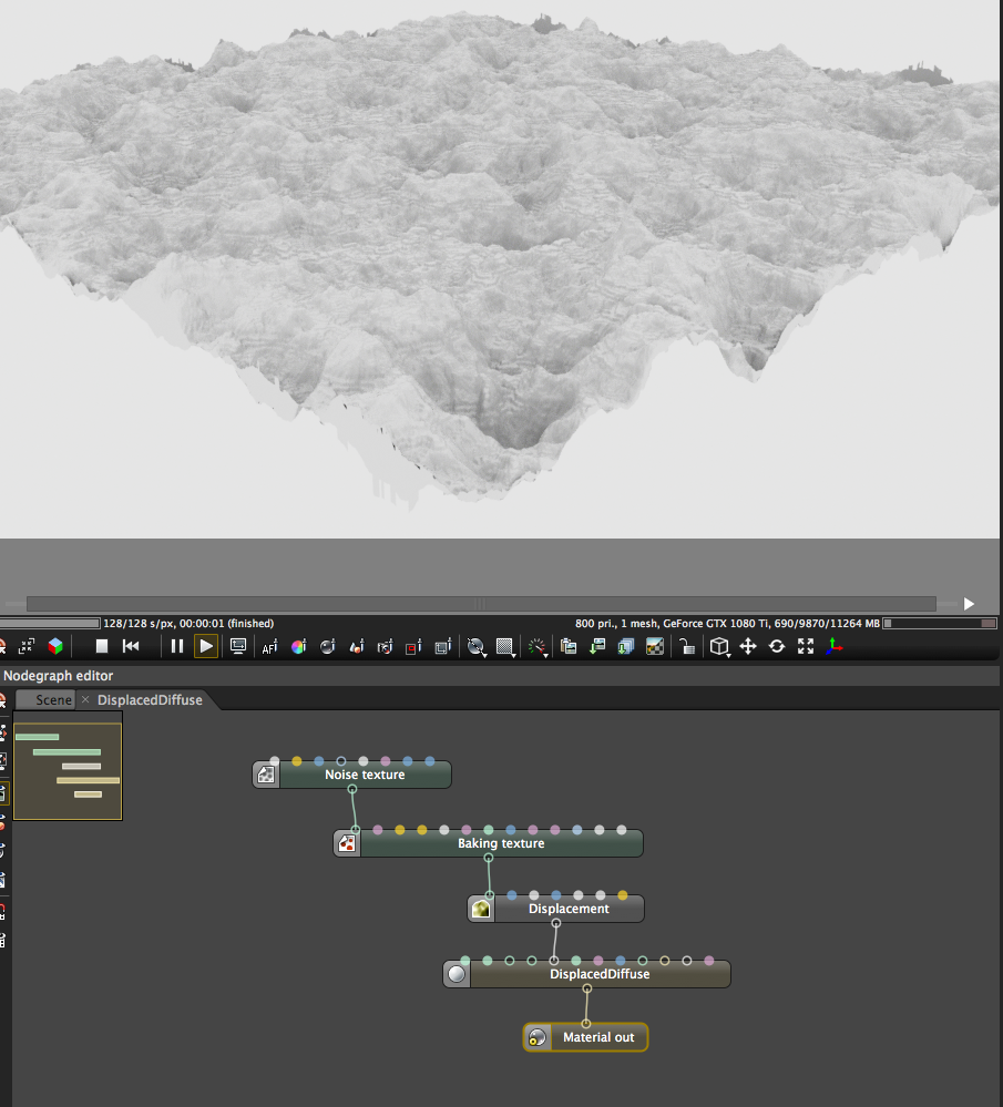

Hey everyone,
i'm trying to use a procedural texture as a displacement, but when I go into the "textures" menu, the Baking Texture node isnt there in the "mapping" category.
There's a baking image node, but when i plug that in, it just creates its own texture, disregarding the procedural I made.
Im working with Octane 4.05
Any ideas how to solve this?
Thanks in advance!

If I'm understanding you correctly, you need to plug your procedural node into the "texture" input of the Baking Texture node.
bake procedural
bake procedural
