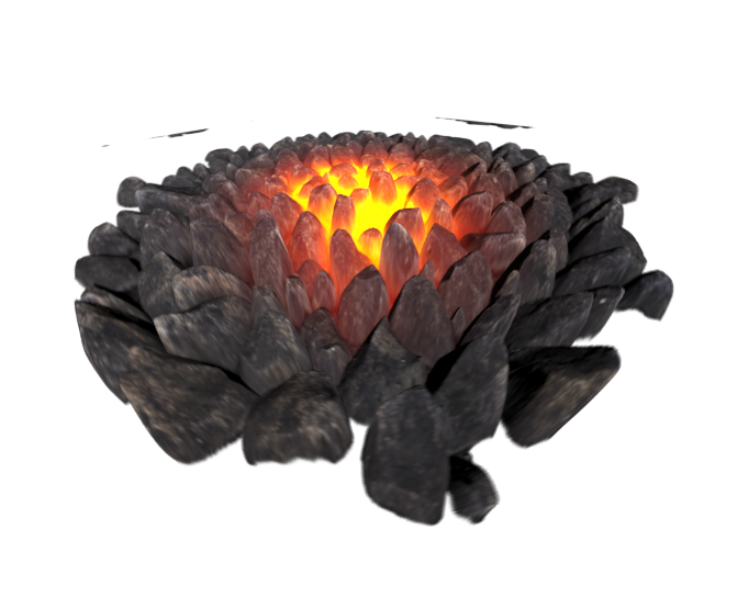

Hi Guys,
Here a new scene, I adjust a bit actually the 2d transform was wrong my bad! here a great result with other type of texture.
Cheers,
JO
Cheers,
JO
