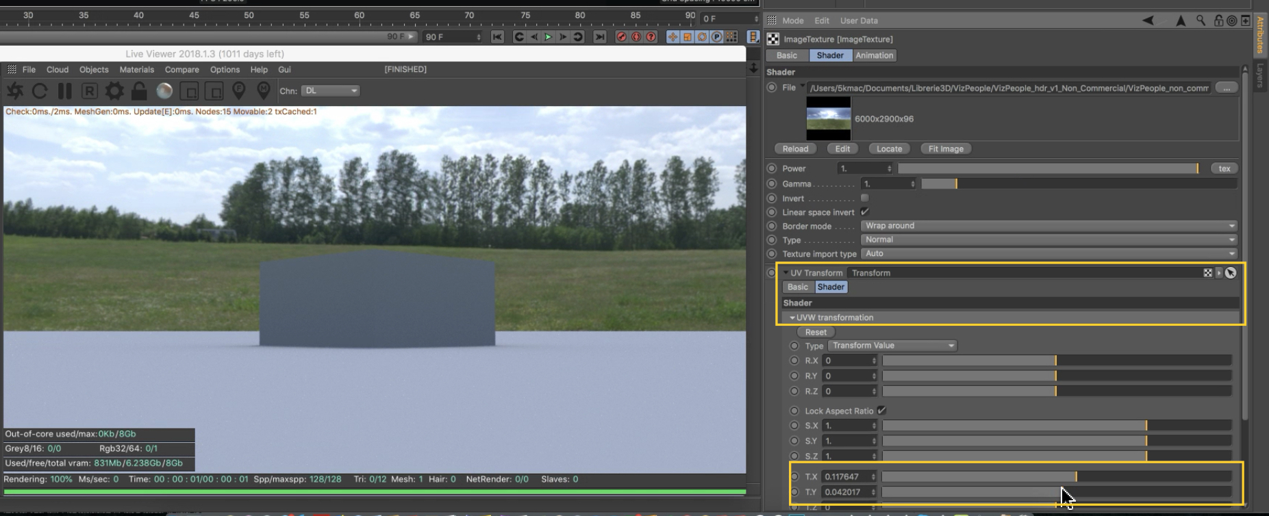

I am trying to simply desaturate an HDRI when using it with an HDRI environment light. I am able to desaturate it but once I do so, the rotation of the Environment tag stops working. Any ideas why? I realize there must be an incredibly simple answer to this but I just can't seem to figure it out. :(

you need to reach the ImageTexture node, add an UV Transform node, and change the X and Y movements:
