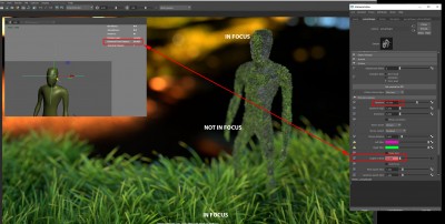

Same scene different question.... I have a locator at my characters head. I put my octane depth of field on my thin lens at the distance that the locator is from the camera lens.
The head is sharp enough for my needs and I can live with the fact that other areas that may be in close proximity to the camera lens distance but "down" in Y from that point. I am assuming that this is accurate DOF.
BUT
Why is the foreground grass sharper than the grass directly beneath the character?
Any help appreciated.
