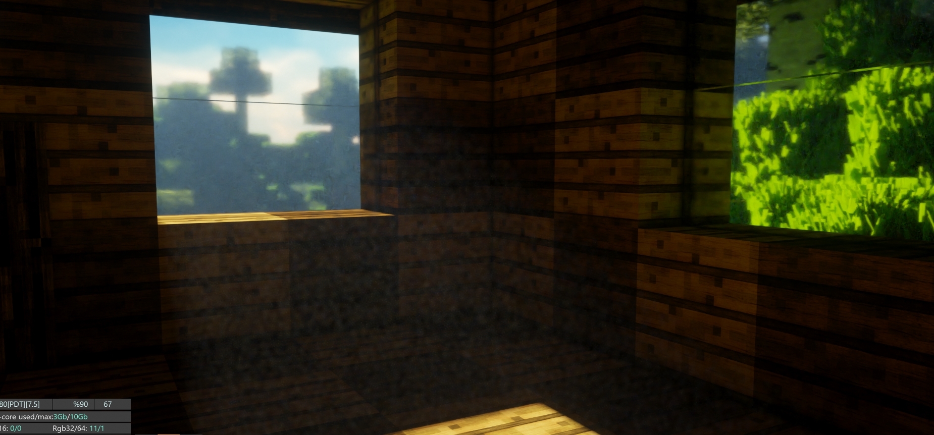

Is there an option to make the denoiser look better without adding more samples too my scene?
Using Pathtracing with denoiser.

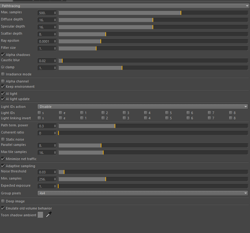

my settings

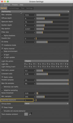

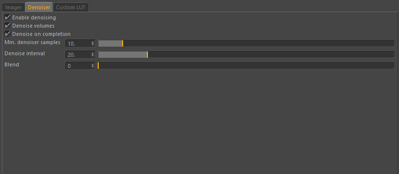

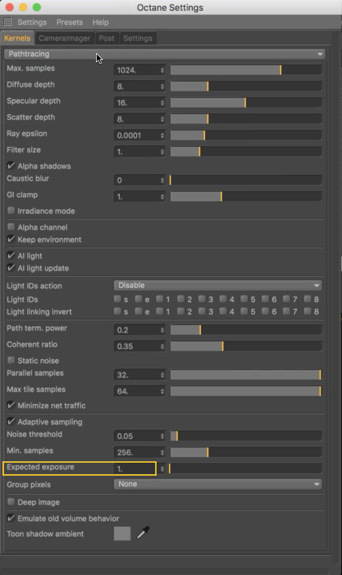

you need to double the sampling, but change the kernel settings to gain more speed:
Please, make sure to copy paste the Exposure value from the Camera Imager node, into the Expected exposure field, if different from 1.
