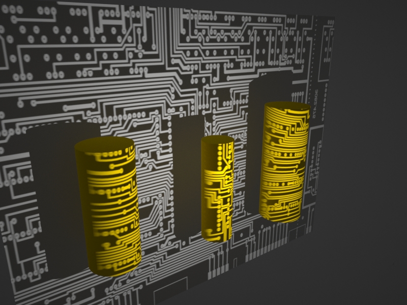

You're right ! I did a double mistake !
I was projecting on the inside of a cylinder, and the projected picture has no precise right and left border... so I didn't see my mistake:
Same projection with hard picture borders - we can see the vertical sides are a little curved :
And now a scene with a correct projection :
And the 3DS Max 2020 / Octane 4 scene file is attached to this post
