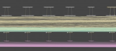

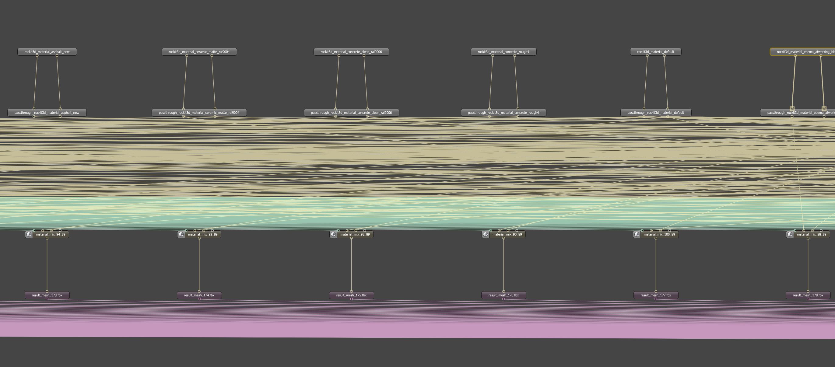

Can we get an option inside Octane that disables the fancy curves (and anti-aliased) lines in the node editor and get simply straight A to B lines instead without anti-aliasing.
I'm developing software to auto-generate node structures for Octane, where the system can auto-fix user modeling errors and a has a whole lot of cool functions that automate tasks, but the node structures which are getting ever more capable/complex, and even dragging the view around in the node editor is a lagfest.
Octane itself can perfectly handle all this to produce the end-result renders. But working in the node editor is a real problem.

Please see attachment.

We have already tried what you propose in the past but the performance gain is actually marginal. I would advice to group elements of your scene in sub-graphs as much as it makes sense, in that way there will be less load to render all individual nodes and connections and users will be also able to understand better what's going on if that makes sense.
