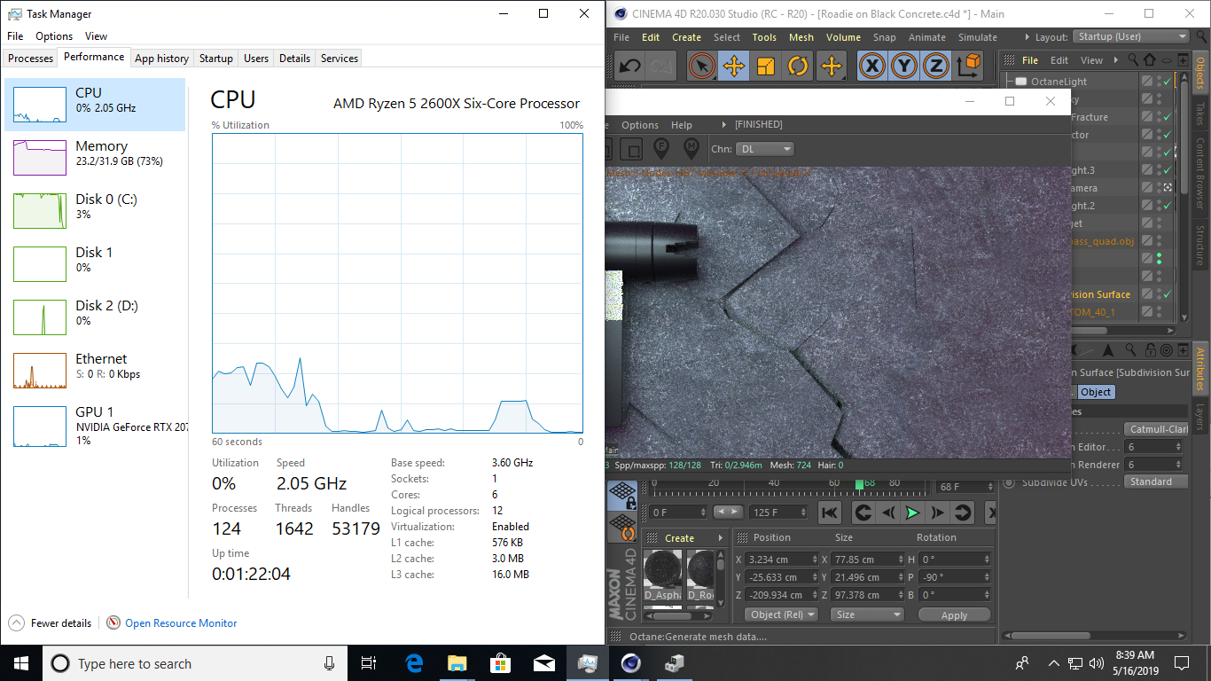

i'm moving computers and installing Octane on a new Desktop that has a GPU RTX 2070. I've installed the Nividia drivers and the Cuda drivers and everything. But the computer is very slow when i open a scene and the GPU percentage being used is 1% to 5% maximum. Attaching reference.

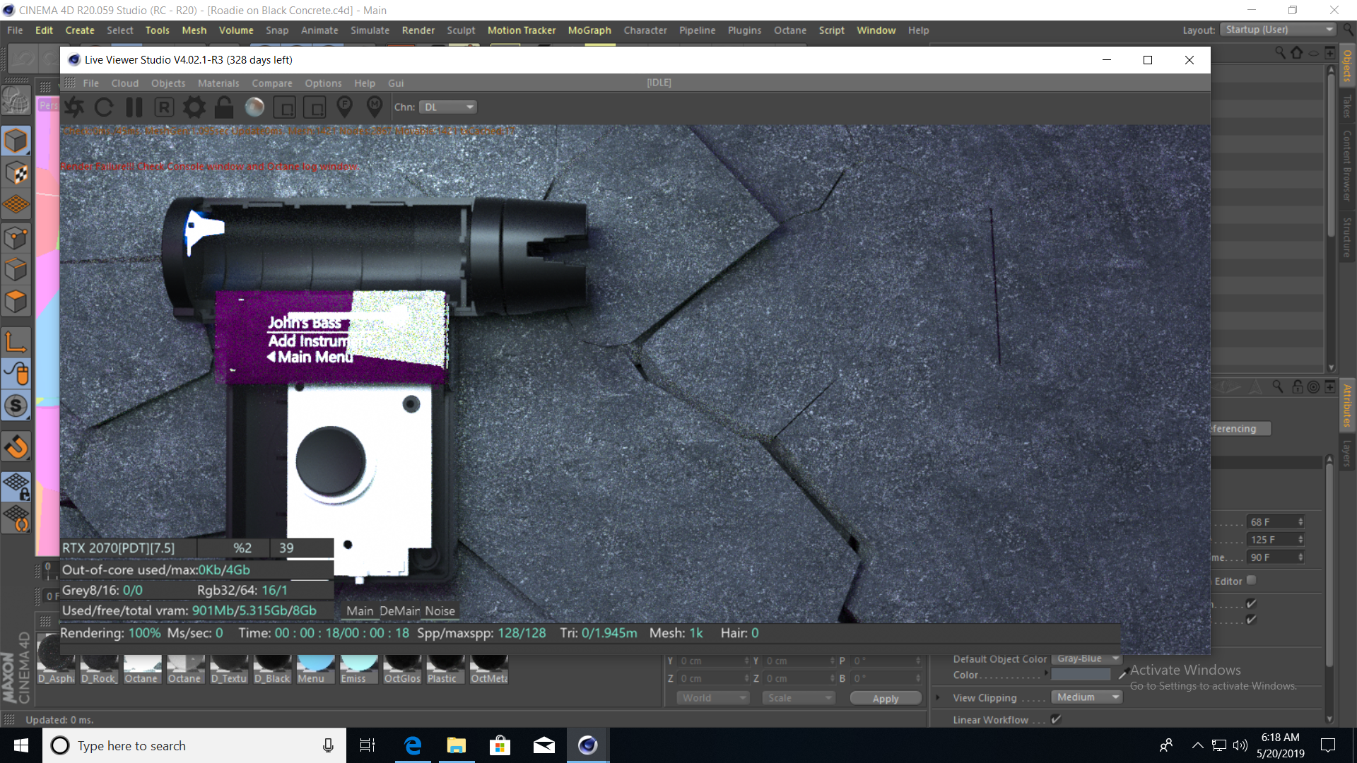

The weird thing is that on Live Viewer it says RTX Driver is being used 80%, but the computer is very slow i'm sure its not using it, and on the Task Manager its clear its only using 1%
Posts: 10616
From Windows you can see only CPU, or GPU usage in OpenGL mode, not CUDA rendering.

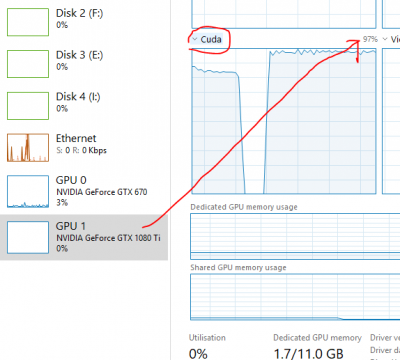

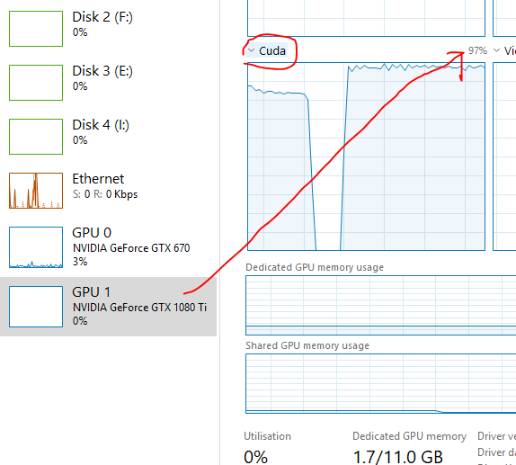

GPU-Z is much better for this, but you can see Octane's GPU usage in Windows task manager as well.
Select the GPU in the left column, then change one of the right hand graphs to "Cuda". Cuda seems to be a new addition (?). I would previously use "compute_0" or "compute_1" to check gpu renderers.
EDIT: Yes it seems only my 1080 Ti shows Cuda. On the 670, I have to choose "Compute_0". I'm not sure why it's different on each card.

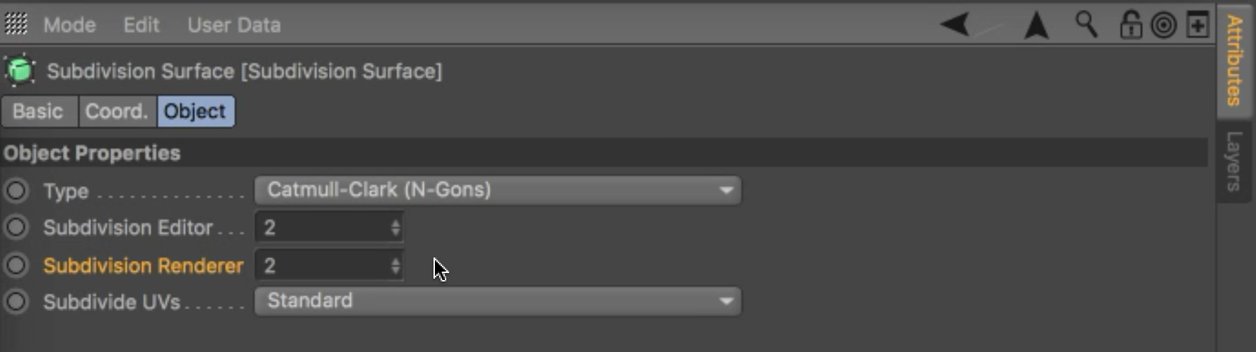

Most likely you have different subdivision settings for viewport and final render in some c4d objects:
