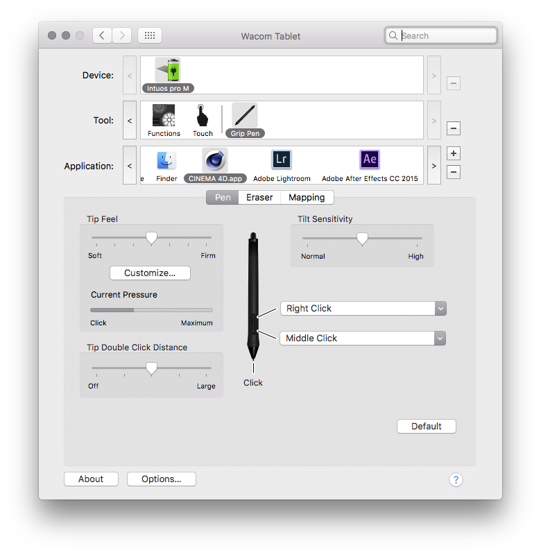

Don't know about the magic mouse, but for wacom you certainly can.
You can customize the pen per application. These are the settings I use, and it works great.
OSX 10.12.4 | Intel 12 core @ 3.33 ghz | 128 gb ram | NVIDIA GeForce GTX 1080TI | Ubuntu Linux slave with 3x 1080ti

my problem is I hate using the buttons on my wacom pen - I'm forever pressing them when I don't want to - I'd much prefer to hold down a key to invoke MMB and left click with the pen
niestudio
Posts: 265
Joined: Fri Aug 21, 2015 10:03 pm
there is a program for mac called Karabiner that lets you have more control over your keyboard. You might be able to do something in there.
