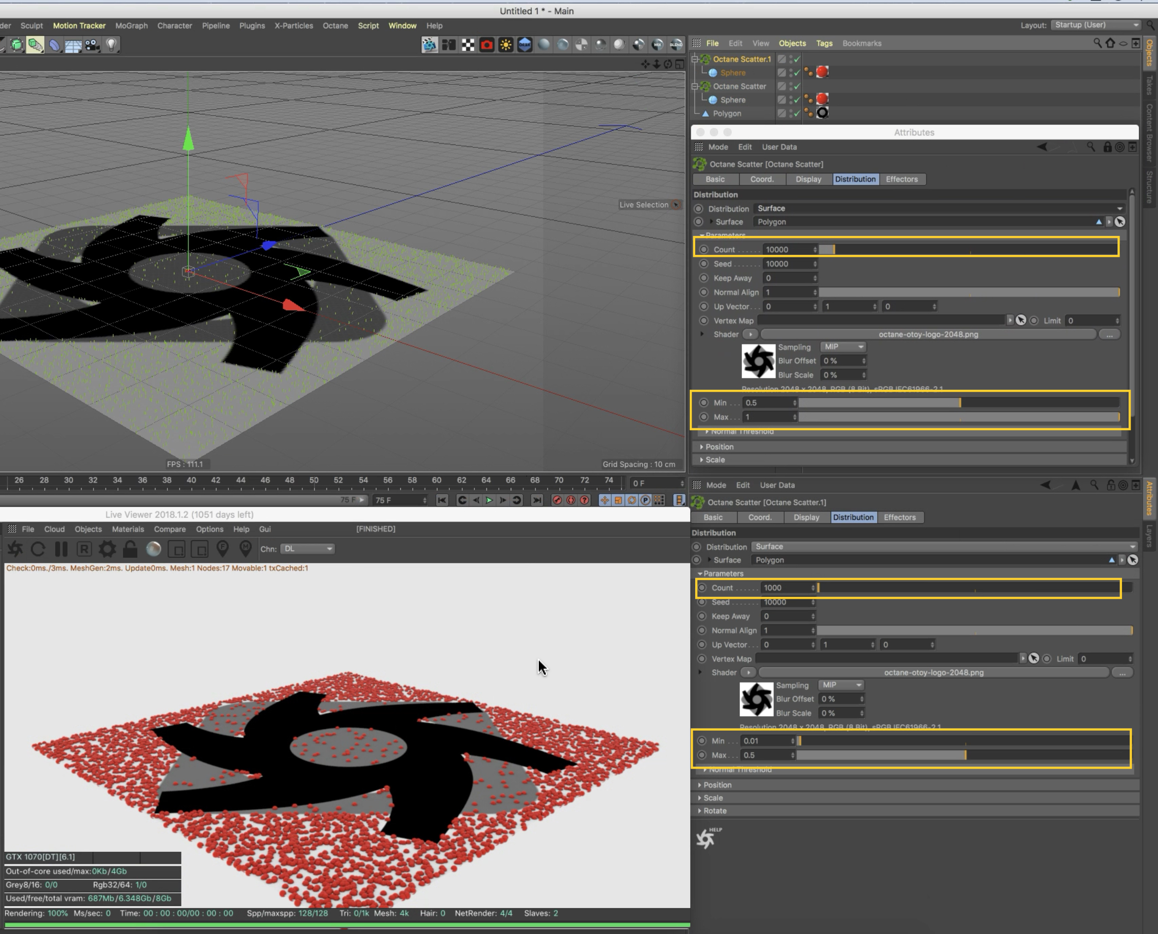

Hi Valentin,
have a look at this solution with two Scatter objects, with the same distribution map, but with different Count, and Min/Max values, to restrict the clones on specific color/zone:
ciao Beppe

It looks like the "number" is controlled by the "Count" which also controls the "density" (20 is 2X 10) in a restricted area.

How about deploying the two sizes on two scatter objects? I encountered a similar control problem with Forester that was solved with two scatter objects with two different plants.
