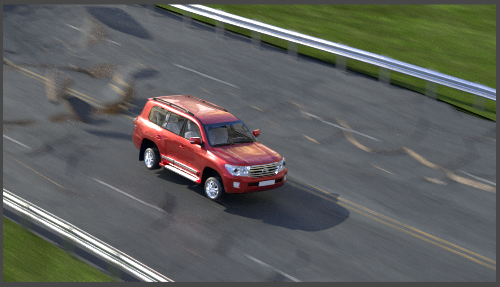

I have a scene where an aerial camera is pointed down and following a car driving on a road. One would expect the environment that it's moving through to be blurred, but for the car not to be heavily motion blurred. In my scene, Octane is rendering the car with the same amount of motion blur as has been applied to the background. It looks very wrong.

Ah probably not sir! I'm sure it's behaving exactly as it's supposed to, I'm just ignorant of how to tweak it to my liking.
I have an octane object tag on the car null, with transform/vertex turned on. So it's no longer looking weird...except the wheels lol. They have shrunk in size for some reason! I'm assuming I need to put different tags on the wheels?
