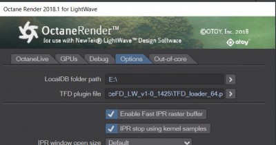

Im learning Turbulence FD as I have to make a video where fire will be necessary.
I made some tests with the demo version using lightwave native rendering and everything is fine but how do you make the
Turbulence demo work with Octane? I switched the scenes to Octane but even if in the preferences I tell where the plugin is I don't see anything
in the IPR.
Is the trial working with Octane or Im missing some other steps to make it work?
Sorry I couldn't find any info around.

Yes, I think that the TFD demo version doesn't support the external renderers API. Do you get any error in the Octane log file about it?

I bought Full licence of Turbulence FD but still I can't see how it works with Octane.
Despite I had the octane volume item to the container and put the ramp node in volume editor I can't see anything.
Have someone a sample scene to look at?

Do you have the right TFD plugin .p file path/file in the plugin options panel?

Hello sorry for the late reply.
I fixed it!

I'm using LW 2020, and I cannot for the life of me get Turbulence FD volumetrics to show up in the IPR window. I've searched the forums, YouTube, and Facebook, and all of the settings that I've found are for pre-2018 versions of Lightwave.
Can someone please help me out?

The settings should be the same, or is there any change in TFD for the latest LightWave versions?
