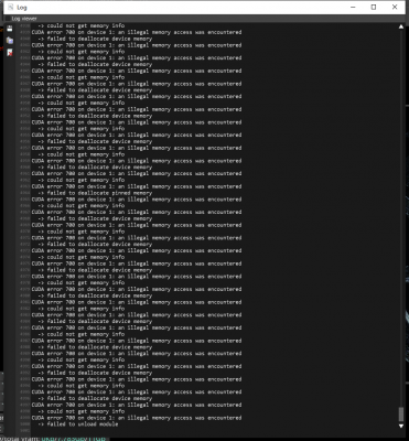

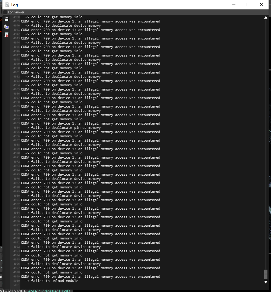

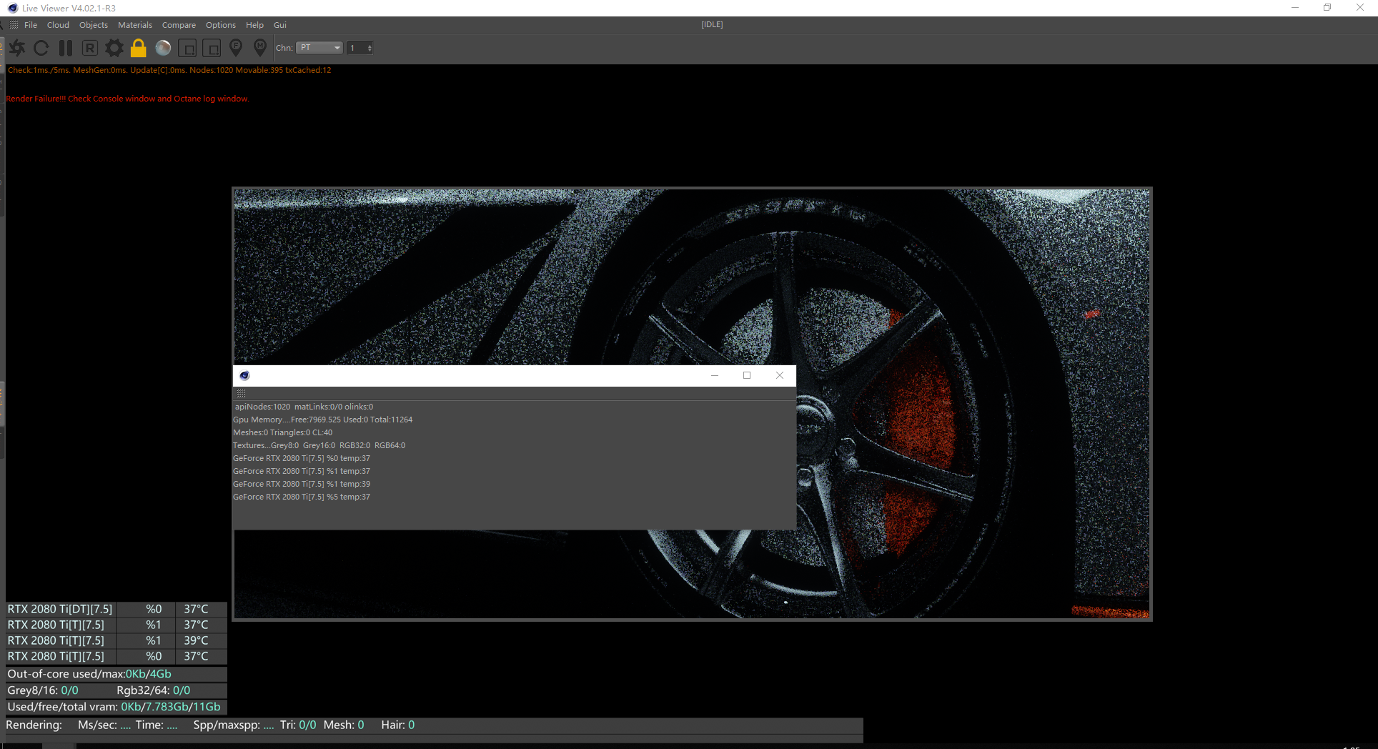

I got my new machine month ago.When I click render button the system frozen and crashed.Most time I can't even move my cursor but reboot.It happens with Nvidia drivers from 417 to the latest version and all Octane v4 builds.
I have tried lots of suggestions like using DDU or changing the timeout with the TdrDelay key but didn't help. :cry:

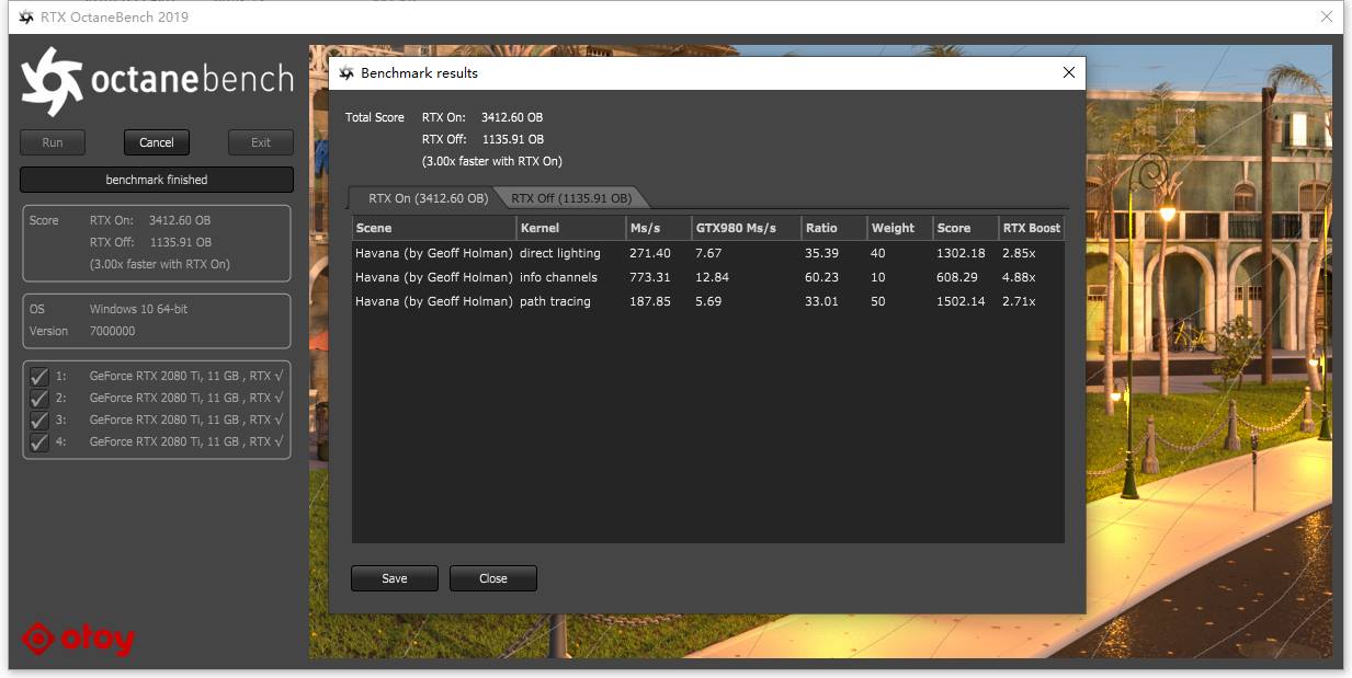

I can use all GPUs with redshift and Octane benchmark is fine.So it seems not simply hardware problem. :cry:

Did you try Octane Bench with all cards seperatly? I get like 300 points on the first, second and third card, but the 4th card has much lower score (around 150-250 OB).
Not a solution jetz, but I can render with 3 cards without crashes and I can get 900 octane bench with the first three cards (list sort in octane bench and msi afterburner, windows list has an other order of the 4 cards).

please use OctaneBench 4.00c for your tests, to have more comparable results:
https://render.otoy.com/downloads/a/787 ... 0c_win.zip
Also check with GPU-Z the GPUs sensors while rendering.
