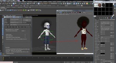

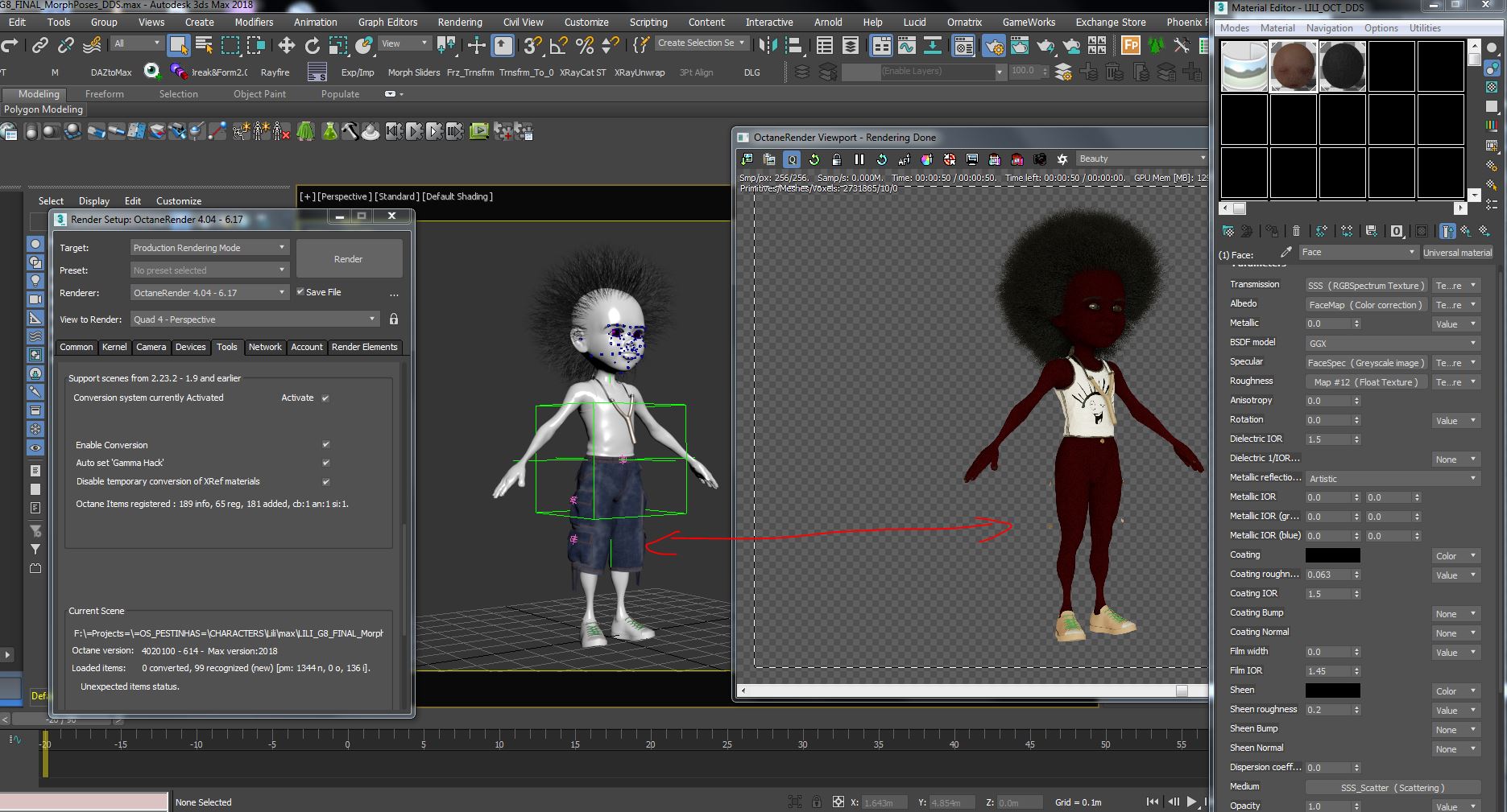

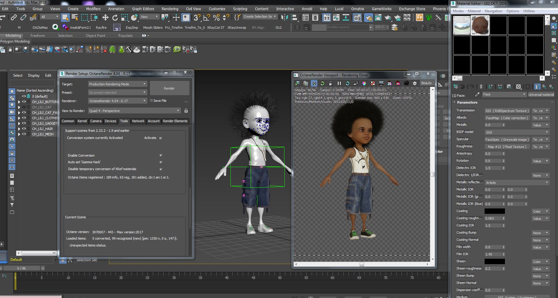

I've been trying to use ver 6.17 to render but shaders are turning up wrong... when I use load a file created with either 6.12 or 6.14 shaders will be wrong.
if i merge an object(s) from 6.14 to a clean max file in 6.17 and render it will initially render OK...but if i save this file and reload it will render badly.
please help...i can provide file if necessary
at some point octane recommends activating conversion but even that will not work.
please fix this I'd love to take advantage of the latest versions

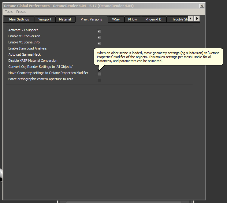

Thanks Paride.. i will try that, i never would have guessed that..
but what will happen when i use this file in future versions? will I have to reconfigure anything for it to be updated?

Hi nildoe,
Next Octane for 3dsMax plugin release should fix this issue.
