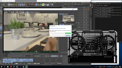

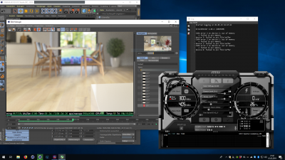

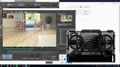

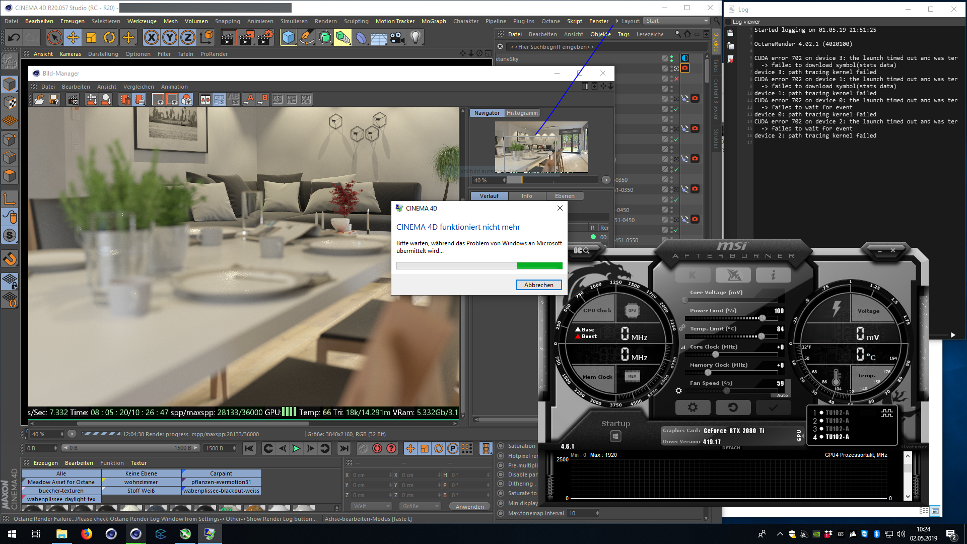

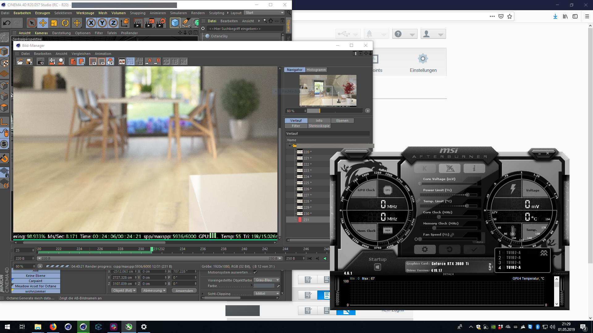

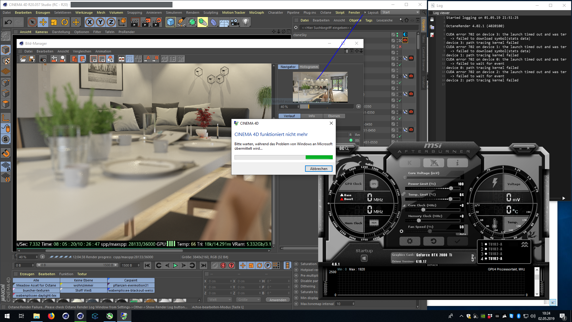

This night I tried to render a 4K interior image.
for testing purpose I really cranked up the samples (to 36000) to have 10 hours of rendertime. after some hours I got cuda error 702 and cinema crashed (see screenshot)
the 4th card totally "died" and came back up after restart (had this several times now).
The 4th card is not showing anything in MSI Afterburner anymore and cant be regonized by "Corsair Link 4" Tool. Restart helped and the card is back.
See several screenshots of crashes.
When I had driver 417.22 I got total system crashes and no chance for screenshots.
Would be great if anyone got ideas for solving.

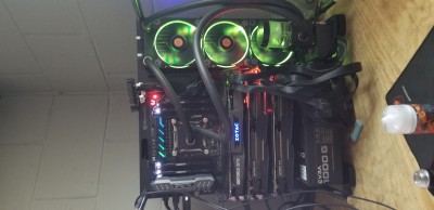

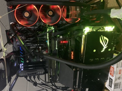

i used to have a problem like this.... did you check your temps??? maybe they dont have enough room to take air...
No Air space
No Air space
No Air Flow
Solution
My Solution
My Solution
Now I dont have any problems with crashes rendering in Octane
