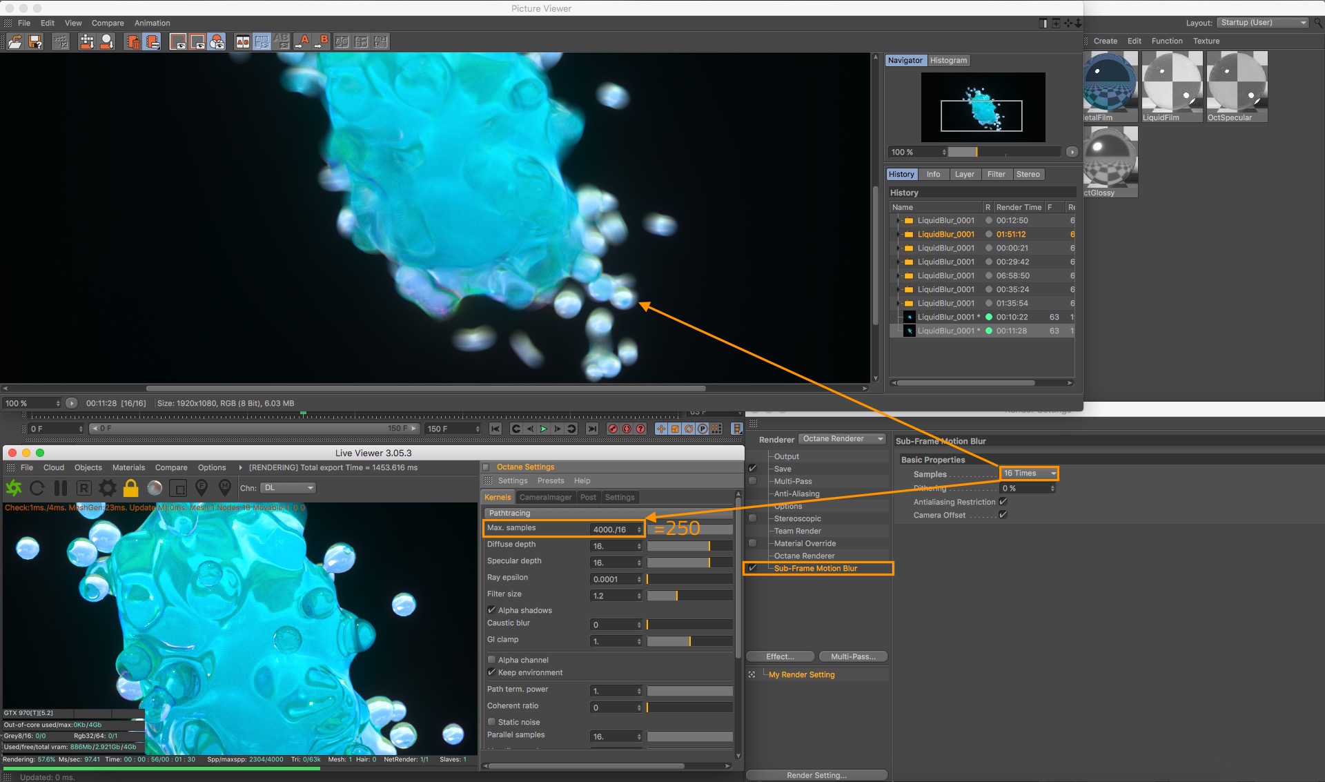

If you cannot obtain the vertex velocity, a workaround is to try with sub frame motion blur:
ciao Beppe

Thank you very much Beppe, I didn't know that, I will experiment it. Should I disable all other Octane Camera Motion blur when applying Sub frame motion blur ?

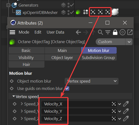

if the number of vertices is not constant, you need Velocity X, Y, Z tags on the Alembic object to be able to set the Motion Blur in Vertex Speed mode: ciao,
Beppe
Beppe
