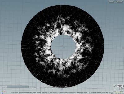

Is there any chance to project texture on a hair? Planar would be enough
. Or any chance coloring curves per point attribute? Also, I tried to resample curve and convert into small lines but black color translated into green and that into grey. So weirdly I and up with grey instead of black, black instead of grey and white was white. So that did not help as well... Or is there any other technique to get a result like on a picture? Thank you.

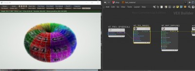

Currently, the hair curves don't support per point attributes or UV coordinates. You can use a UV map, but each curve is going to use the same UV in all its points. You can try to use the available Octane projections to see if they help, as you can see in the attached image.
Hope it helps,
-Juanjo
