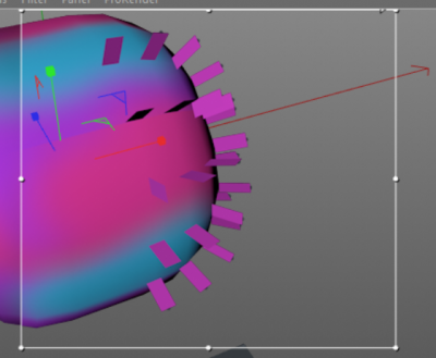

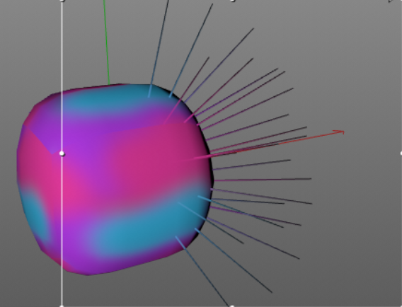

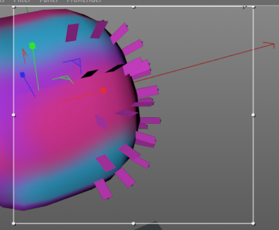

Thanks so much for the reply. Apologize for the confusion, I am not using the feather object but the hair object.
I am working with cinema 4d's hair system and I love the ability to drive hair color by the texture map of my uv'd object that I am trying to add hair to.
My problem is this doesn't seem to work when you either generate cards or instances off the hair system. What I am trying to do is use flat cards and have those also driven by the hair material so each card picks up the color of the texture map from the uved object there being generated from.
I am attaching two screenshots and a zipped file to my test project file with the setup and textures. My team and I are super stuck and any help would be amazing.
Thank you!
Example_Test.zip
(706.28 KiB) Downloaded 169 times
