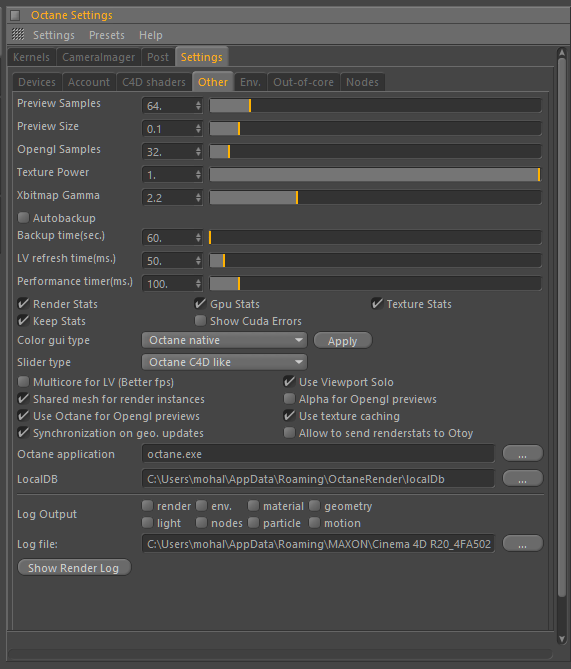

Also can you post a picture from Settings/other?

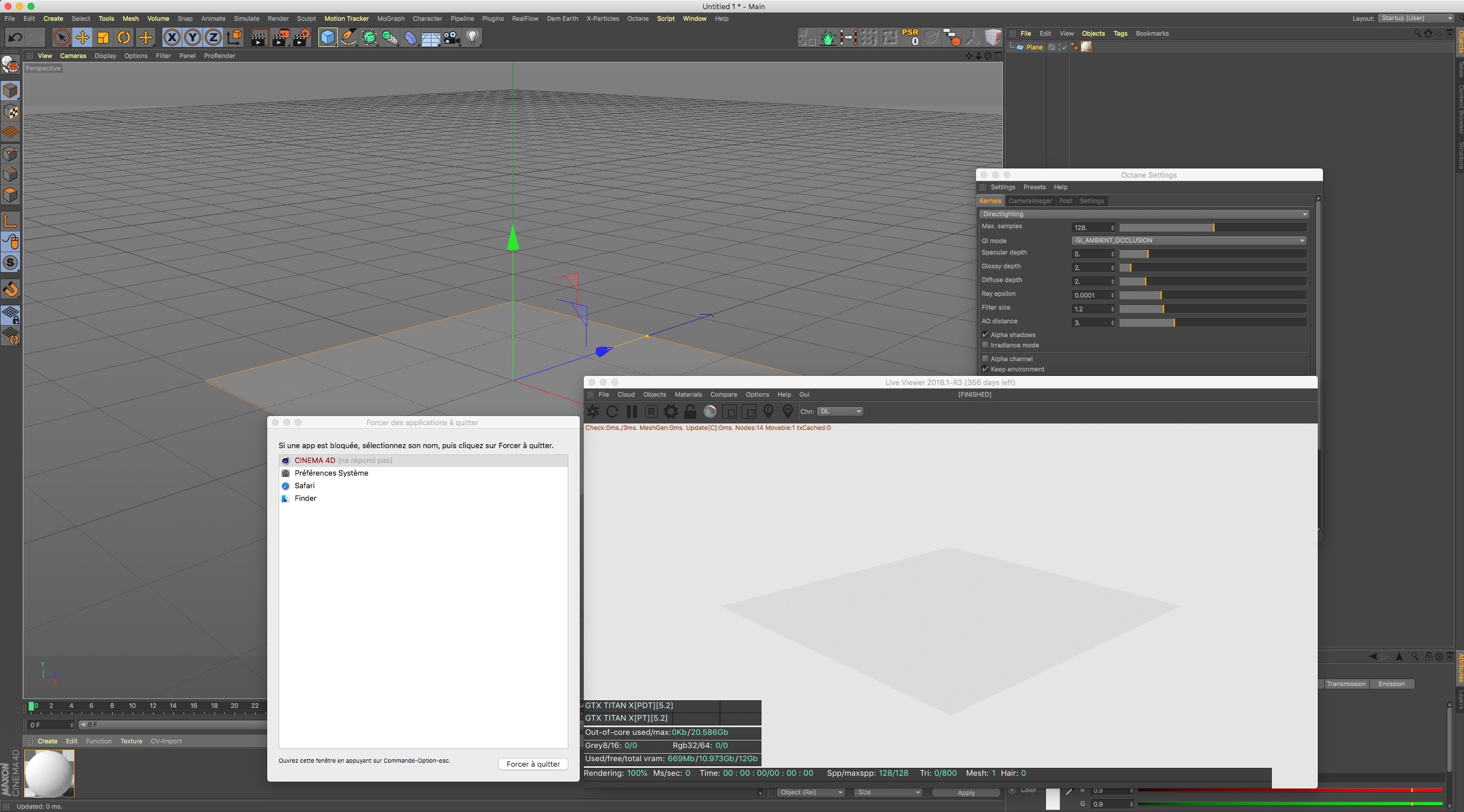

Hi.. i got the same issue on MAC OSX
Hihg sierra 10.13.6
2 * titan geforce x
32GB RAM
Nvidia Cuda 410.130
Nividai web driver 387.10
Octane Enterprise 2018.1.1
Octane Cinema 4D 2018.1.1 R2
Cinema 4D R20.059 (Build RB272827)
Everything works fine until i try to manipulate or create an octane texture

bphoton wrote:Hi.. i got the same issue on MAC OSX
Hihg sierra 10.13.6
2 * titan geforce x
32GB RAM
Nvidia Cuda 410.130
I don't think it's same issue. What's up with Settings/Other? Send me a screenshot from this section with all parameters. To PM

HI aoktar,
I've removed all the plugins and it is still happening. I have reverted back to 2018.1 now, everything works so far and this bug doesn't happen.
New files from clean run without plugins attached.
