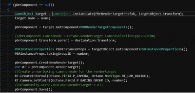

Hi Chris,
Here's a few notes from my programmer:
- You might want to flag to Chris from Octane that he had a typo in his suggested code. Octane.P_BAKING_GROUP_ID doesn't exist. It is actually Octane.PinId.P_BAKING_GROUP_ID.
- Second, when instantiating the PBRRenderTargets in the CSV Writer script, these are created without a RenderTarget property. So I can't call the obj.RenderTarget.Camera.SetPinInt function. I found that I can call obj.CreateNewRenderTarget() after instantiating the object, and then set the PinInt, and I don't get any errors but it also doesn't actually update the BakingGroupID. So probably more work to be done there.

Octane for Unity updates changes in batches. This means that changes are buffered and will only have effect after OctaneUnity.Scene.Instance.UpdateScene() is called.- Second, when instantiating the PBRRenderTargets in the CSV Writer script, these are created without a RenderTarget property. So I can't call the obj.RenderTarget.Camera.SetPinInt function. I found that I can call obj.CreateNewRenderTarget() after instantiating the object, and then set the PinInt, and I don't get any errors but it also doesn't actually update the BakingGroupID. So probably more work to be done there.
Additionally, if you instantiate a PBRRenderTarget component via code, you will need to
I thought you already had an RT ready. If you want to set everything up from script for baking you need to do the following:
Code: Select all
//Create the rendertarget
var RTComp = targetGameobject.AddComponent<OctaneUnity.PBRRenderTargetComponent>();
RT.CreateNewRenderTarget();
var RT = RTComp.RenderTarget;
//Create a new baking camera node for the rendertarget
RT.CreateInternal(Octane.PinId.P_CAMERA, Octane.NodeType.NT_CAM_BAKING);
//Set the baking ID
RT.Camera.SetPinInt(Octane.PinId.P_BAKING_GROUP_ID, 12);
//Set the rendertarget to the scene. (This will make the OctaneUnity use the new RT for rendering)
OctaneUnity.Scene.Instance.RenderTarget = RT;
//Update. This will update all the changes up till now
