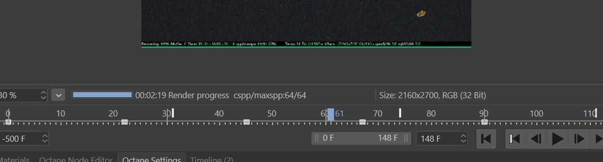

I can confirm this is true. If denoiser is active PMC render gets stuck at 100% screenshots attached.
I thought I'd leave this here as info for others
