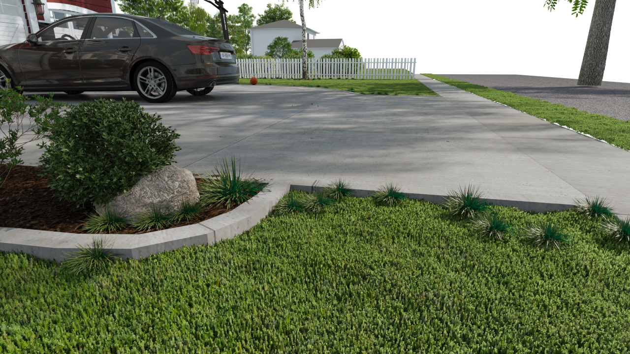

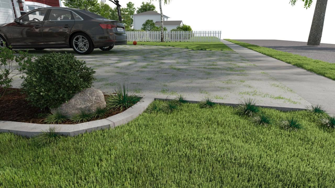

I have a question about the displacement in the new version of octane (4.02.1)
I wish I could convert a scene from the 3.04.4 version to 4.02.1 but some materials looks different once they are convert to the new version, especialy the displacement.
As you can see on screenshots, the grass looks very different but the parameters are the very same so I cannot figure out what is wrong with this matérial. We can see on the new version the grass is taller and thinner but the mid level is the same as the previous version. It's as if the parameter of the displacement texture was manage in different way than the version 3.
So, maybe somebody know what I am talking about and I hope you will be able to give me the solution to this issue.

V4.02.1
V4.02.1
V3.04.4
V3.04.4

Hi There,
I think you need, use the 4.05 and this is the "mid level" settings at displacement node, hope this help out.
Best,
JO
