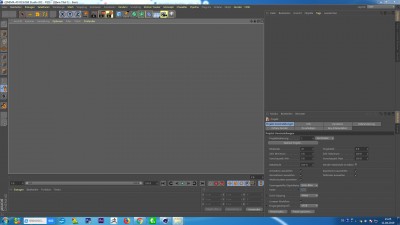

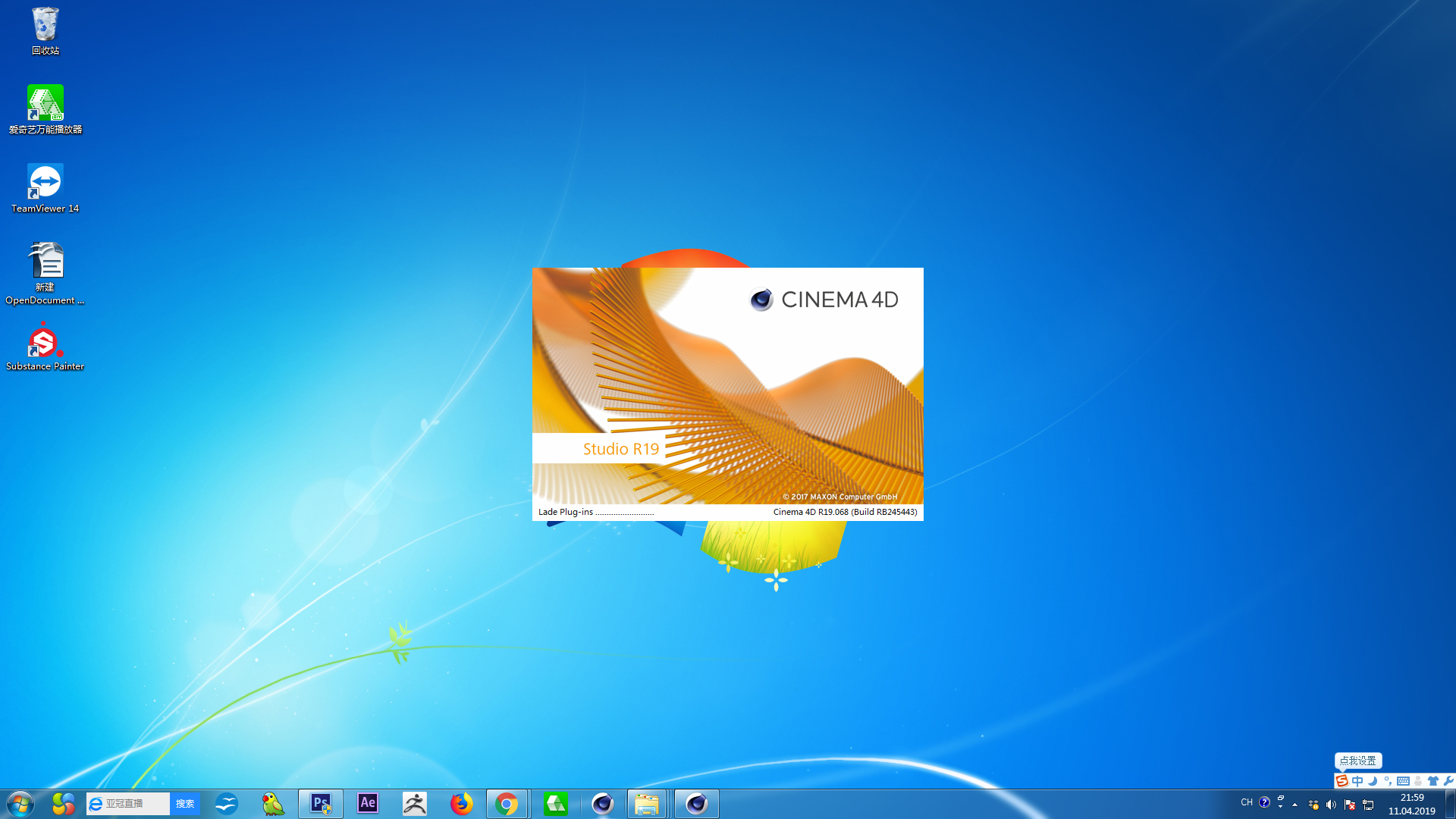

H. I´ve recently bought the license for OctaneRender® All-Access Extension (1 Year). Then I downloaded the OctaneRender-for-C4D-2018_1_R3_win, then I installed, then I can´t use C4D anymore.
After the loading with the C4D logo picture,
will C4D freeze in this screen, like for ever.

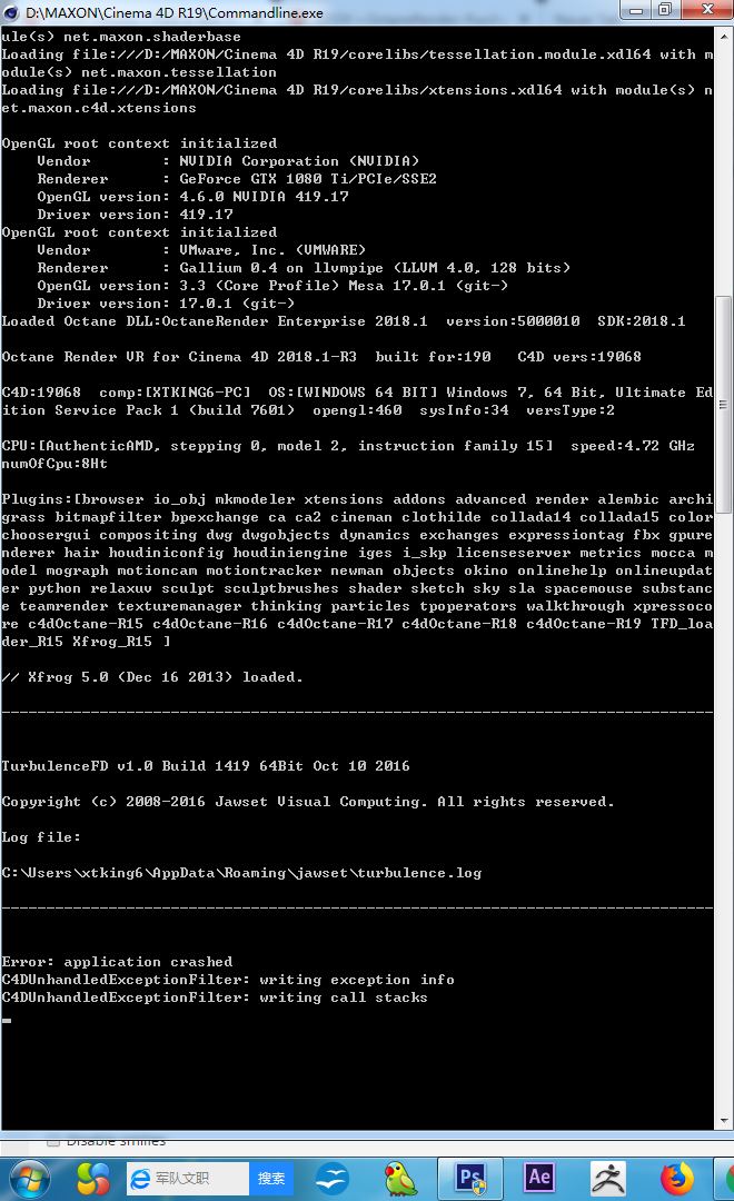

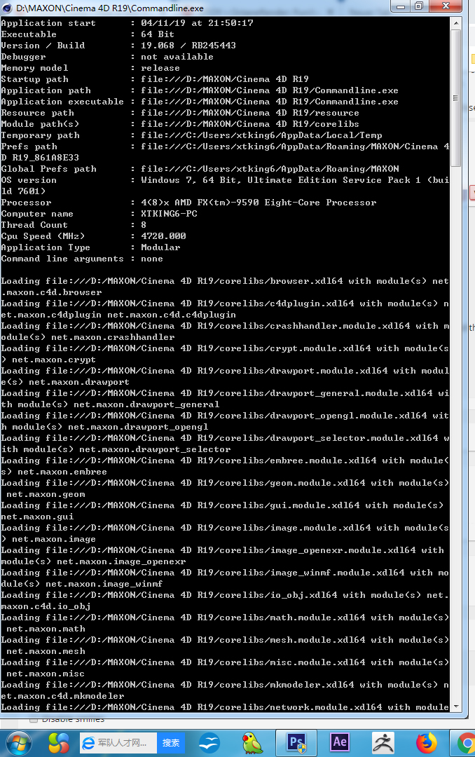

I. Here are the screenshots of the Console window outputs from C4D

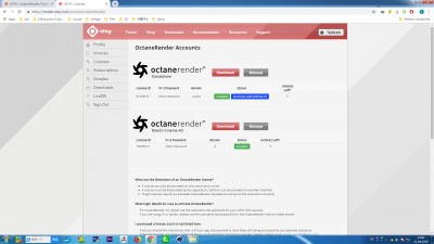

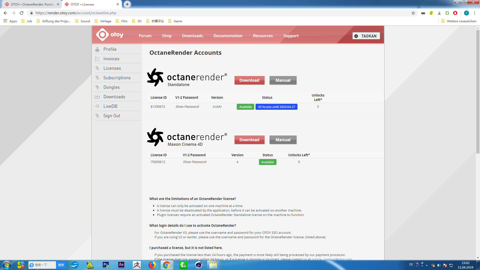

I just checked the Status in my licenses. They are all Availalbe, but still not Actived. That means the licenses are still not activated on my computer. Do you have any clue?
I did remove all the files in the Plugin folder. But still don´t work.
As you can see that from log output, there's still R15/16/17/18/19 plugin files. Show content of c4doctane folder please! And remove unnecessary dlls as we wrote on install nodes. I'll be happy If you can move this topic to out of bugs section.
