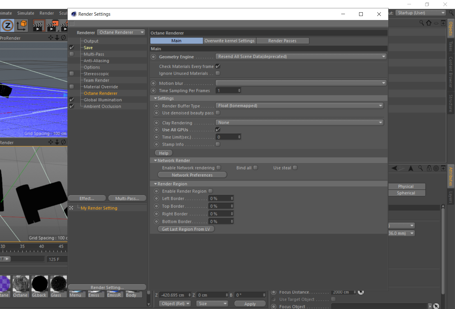

I read the forum to get my answers but on my version of Octane there is no "Update Method: Faster Updates"

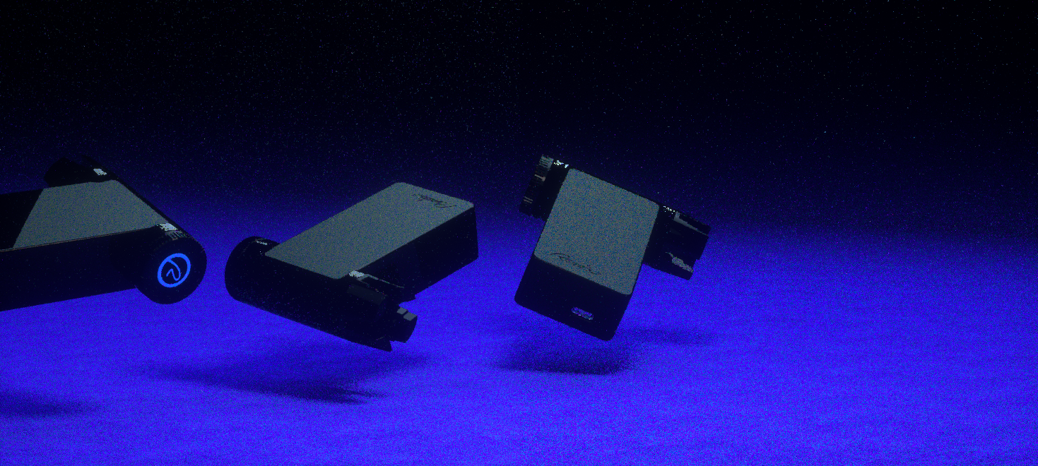

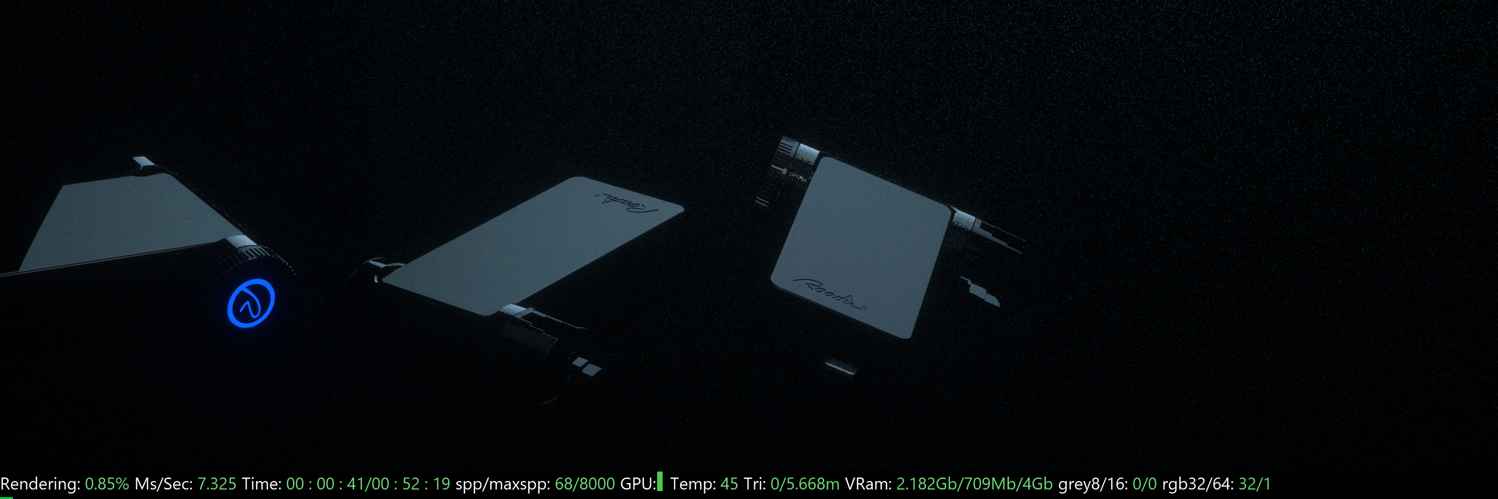

The image in the C4D render is still appearing super dark in comparison with the live viewer.

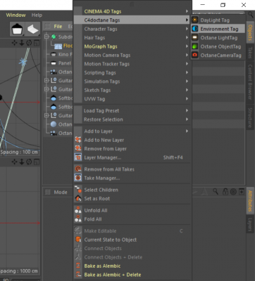

Also, is this how i add an object tag? : right click on Tags/C4DOctane Tags/ then pick Envrionemnt tag?

c4d render
c4d render
Render Settings in Octane 4.02 are different
octane live viewer
octane live viewer

please have a look at the documentation here:
http://www.aoktar.com/octane/GeneralSettings.html
Always keep the Geometry engine to Resend only updated objects, and the Geometry controll to All objects movable.
Finally, always create a new render setting specifically for Octane Render, without c4d render effects in it, like GI or AO.
