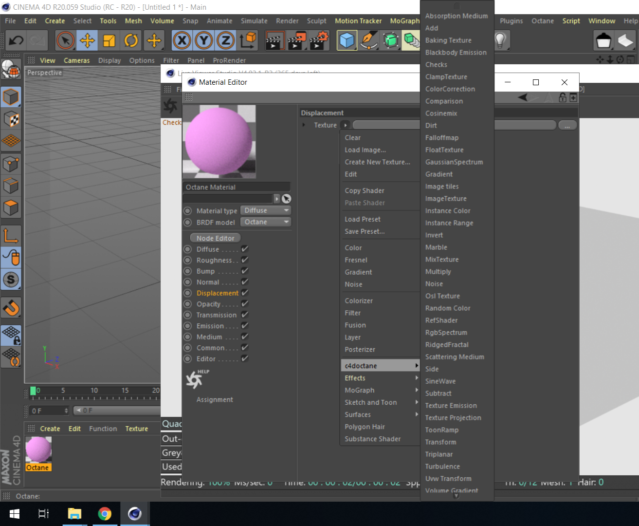

im trying to create a material that has displacement on Octane 4.02. Before i used to right click on texture, go to c4doctane select displacemenet then pick the image.. now it seems "displacement" disappeared from c4d octane in "Texture", and when i upload an image it doesn't work.. any idea how i can fix this for this version? thanks

attaching a reference.. im watching many tutorials that seem to mention that Displacement is in the c4doctane but its not on my version...

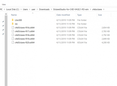

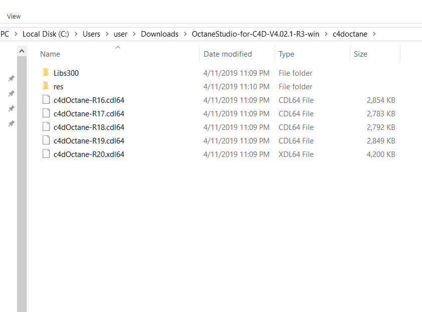

i removed the "C4doctane" folder from "plugins", opened C4d, Octane was not there.
Then i readded the c4doctane folder to plugin, deleted the R's except 20, reopened C4D and Octane was there, but the problem is still there. i still cant see "Displacement" in the list.

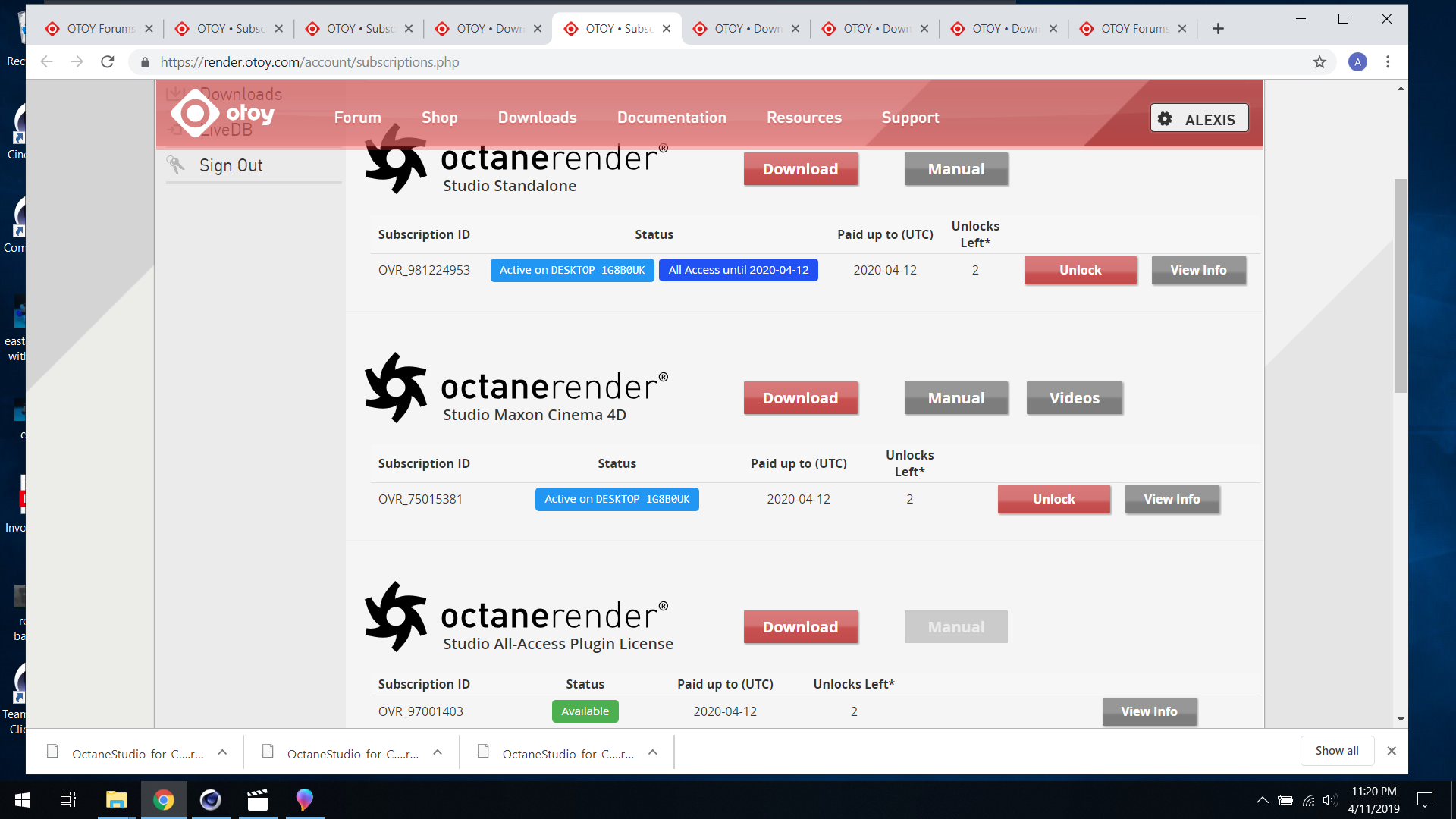

I am going to my subscription page, all 3 files to download are downloading the same thing it seems "OctaneStudio-for-C4D-V4.02.1-R3-win" its 46 mbs zipped folder, Attaching reference
Can you please further explain where can i find "Install Notes"? What am i doing wrong? Do i have to download the version thats after 4.02?

2- if you read my previous post, i have already installed this exactly as it says in youtube link. My Octane 4.02 seems to be working fine in all aspects except for "Displacement", I cant seem to find it in the menu as per the attachment below.
3- All 3 Subscriptions in my page ( Studio Standalone, Studio Maxon Cinema 4D, Studio All-Access Plugin License) are redirecting me to download the same file "OctaneStudio-for-C4D-V4.02.1-R3-win"
4 - Where can i access the standalone application (.exe file)? Should i uninstall the current exe version i have, then install it again, then add "c4doctane" to "plugins" again from scratch?
all 3 "download" buttons are redirecting me to download the same file

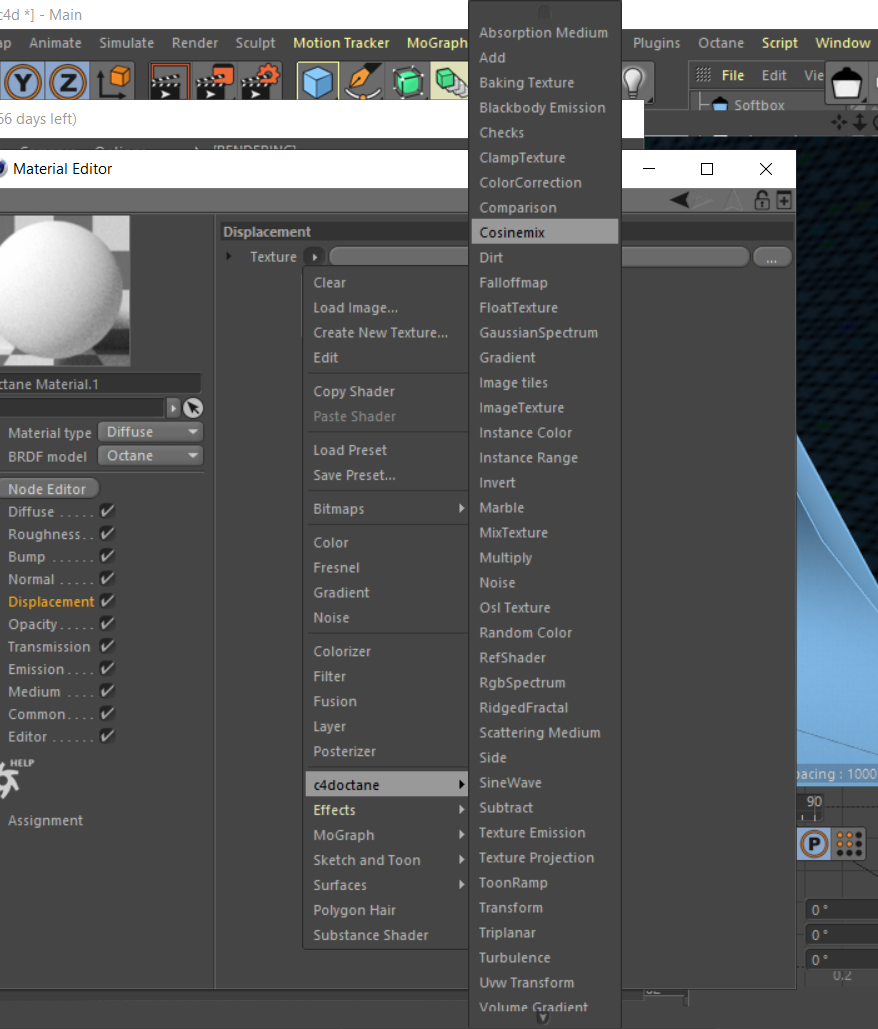

Update: I just uninstalled Octane 4.02, deleted the folder from Plugins, then Installed Octane again from scratch and re-added the folder inside Plugins, im still facing the same problem: i cant find displacement in the attached.
Help! Without Displacement then really most of the fun of doing the work isn't there.
Much appreciated.
Displacement still missing after second installation
Alexisbaydoun
Posts: 44
Joined: Tue Jan 29, 2019 2:03 pm
Much appreciated.

It's same on me. But why don't use "add displacement" button?
carliux99
Posts: 1
Joined: Fri Aug 14, 2020 8:58 pm
I don't know if this gonna be useful but you have to click on Add Displacement button. Then double click on the white square/shader and you can add your image by clicking the three dots. It worked for me.
