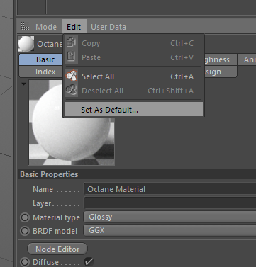

You can set your own defaults in C4D.
Once you have it set up the way you like it (BRDF model, etc.), go to Edit>Set As Default. It will save it in your presets folder in the content browser. To reset just delete the default from there.
This doesn't work if you create new materials from the live viewer though. You have to go to Create>Shader...
